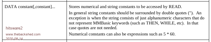

In the above the PRINT reflects the s's & o's ,
but the PLAY SOUND seems not to pick them up ?
my site
Posts: 6626
Posted: 02:55am 13 Aug 2020
You can use a SELECT CASE to do the first option
All the remainder appear to get evaluated so are OK
One mistake you have made is in the DATA statements.
You should surround string data in quotes.
Otherwise MMBasic get confused with variables.
I also increased the first pause so you have time to hear the changes in sound level.
Thank You .... As Often
The first pause needs to be short to give an ' envelope '
Hearing the steps ruins the effect .
It would be such an improvement if PLAY SOUND would accept 0 as a
'frequency' and/or 'volume' parameter resulting in silence ......
Edited 2020-08-14 00:57 by hitsware2
