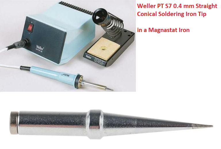

My weapon of choice for building the CMM2 kit:

Posts: 6118
Posted: 03:28pm 13 Aug 2020
Weller Magnastat...the best there is. I bought mine 40 years ago....
The S7 tip is for leaded solder.
For leadfree solder use the S8 tip.
But honestly, the magnastats where not designed for leadfree solder. The higher temperatures limit the lifetime. Mine only gets lead....
I am on my last tip. Haven't checked if these are still obtainable.

  Volhout said  Weller Magnastat...the best there is. I bought mine 40 years ago....
Bought mine 20 years ago, couldn't afford the 24v power supply so built one using a torroidal transformer and associated components.  Works brilliantly.  I also only use leaded solder.
Tips seem to be still available, but quite expensive (£5+ a pop).
