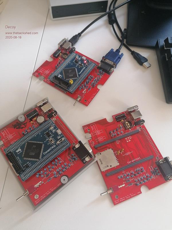

Hi guys
At this point I have assembled three CMM2 boards. All of them works perfectly, except for the SD card reader. I have tried several different SD cards, or course.
At this point I am trying to convince myself that I am wasting my time. I really should pull from the CMM2-project, since I cannot get it to work. At an earlier time I "designed" a CMM1 pcb, with another kind of SD card module - that works perfectly.
There is really no point to this post, other than dispair over the difficulty. I have been messing with electronics in my spare time for close to 20 years, but I think it is time to move on to programming-only. I must make a decision soon
Thanks for your time.

Posts: 11882
Posted: 07:20am 16 Aug 2020
In the PCB pictured without the Waveshare you are missing the 2R2 resistor that powers the SDcard. Won't work without that!

Posted: 12:51pm 16 Aug 2020
  matherp said  In the PCB pictured without the Waveshare you are missing the 2R2 resistor that powers the SDcard. Won't work without that!
Also, if after fitting that resistor it still plays up, check your voltages.  Measure between the USB-B case (-ve) and the 5VIN and 3.3V pins (+ve) on the Waveshare.  Should read around 5v or a tad over, and 3.3v.
Then try with a different USB-A to USB-B cable.
Also some early firmware versions dont like a blank formatted SD card, now fixed in the latest firmware.
Hope that helps.

Posted: 04:02pm 21 Aug 2020
Hi guys
matherp, I have tried several "combinations" back and forth - Upon using solder wick on the SD card solder pads and including/resoldering the 2.2 ohm resistor I got two of the boards working!
I am very happy that I didn't quit. Natural born quitter

Posted: 12:22am 22 Aug 2020
  Decoy said  I got two of the boards working!
Well done
I discovered that dabbing some liquid flux onto the solder braid using a "flux pen" vastly improved the efficiency of the braid to wick up excess solder ... might help you with the third board
