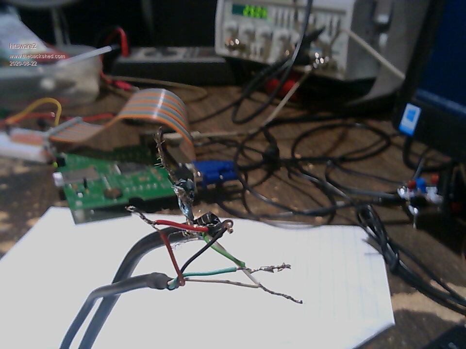

And I saw your picture at https://www.thebackshed.com/forum/ViewTopic.php?TID=12513&PID=152103#152103
It doesn't look like you've got the USB micro-B option either.
hitsware2
Joined: 03/08/2019
Posts: 738
Posted: 03:58am 21 Aug 2020
Yea ..... I ' ve got a kazillion USB cables ,
and not 1 A to A
my site
Posts: 6194
Posted: 06:10am 21 Aug 2020
Since CMM2 is new, comming month SW updates may be coming, so prepare for a decent solution. Very logical is:
For an A-A cable, take 2 out of the Kazillion cables and cut the non-A part off.
On both A pieces solder wire to wire. Typically the wires are color coded. Solder same color together.
For Aussies and Brits:
Typically the wires are colour coded. Solder same colour together.
Or - you order from Ali or Ebay...
capsikin
Joined: 30/06/2020
Posts: 342
Posted: 06:31am 21 Aug 2020
  Volhout said  Since CMM2 is new, comming month SW updates may be coming, so prepare for a decent solution. Very logical is:
I got mine from an electronics shop. I also wondered about soldering an additional socket, USB micro-B or C, to the board, but that would require some more consideration.
hitsware2
Joined: 03/08/2019
Posts: 738
Posted: 06:43pm 21 Aug 2020
Technology Marches On !
Good idea , but still no cigar ( back to Windows this time around )

>>UPDATE FIRMWARE
Then unplug keyboard and plug into RPi ....
My home brew wire evidently didn't work ...
Maybe Tx and Rx need to be crossed as with
some serial connections ?
