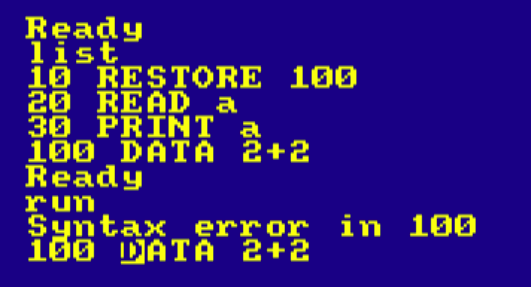

I want to clarify because I haven't seen this explicitly stated, but have seen it kind of implied, and it fits with a test I did. I believe you can't use expressions in data read as a string, is this right?
  Geoffg said  The reason why MMBasic allows expressions was simply because it was so easy to implement and there is no speed or compatibility impact if the elements are simple constants.
And this only applies to reading numbers, not strings?
So if you do:
  DIM tt AS STRING
  tt = "I want this string"
  DATA tt
  READ s$
s$ will be "tt", and not "I want this string"?

  CaptainBoing said  confirmed on my desk uM...
> list
 Dim tt As STRING
 Data tt
 Read s$
 Print s$
> run
tt
but then this also...
> list
 Dim tt As string
 Data ""+tt
 Read s$
 Print s$
> run
> ? tt
I want this string
Interesting, a bit more complicated than I realised. Possibly not something for programs to depend on.
I'm guessing the initial quote or quoted string, in combination with the READ variable being a string, is used to decide to treat the data as a string expression.
I tested a similar thing on a BBC micro emulator.
10 DATA "HEY"+"TH"
20 READ A$
Only "HEY" is read.
but on the ZX Spectrum, "HEYTH" is read. Then I tried unquoted strings. They work on the BBC, at least the simple one I tried. On the Spectrum you can't have unquoted strings in DATA, it tries to look them up as a variable name.
