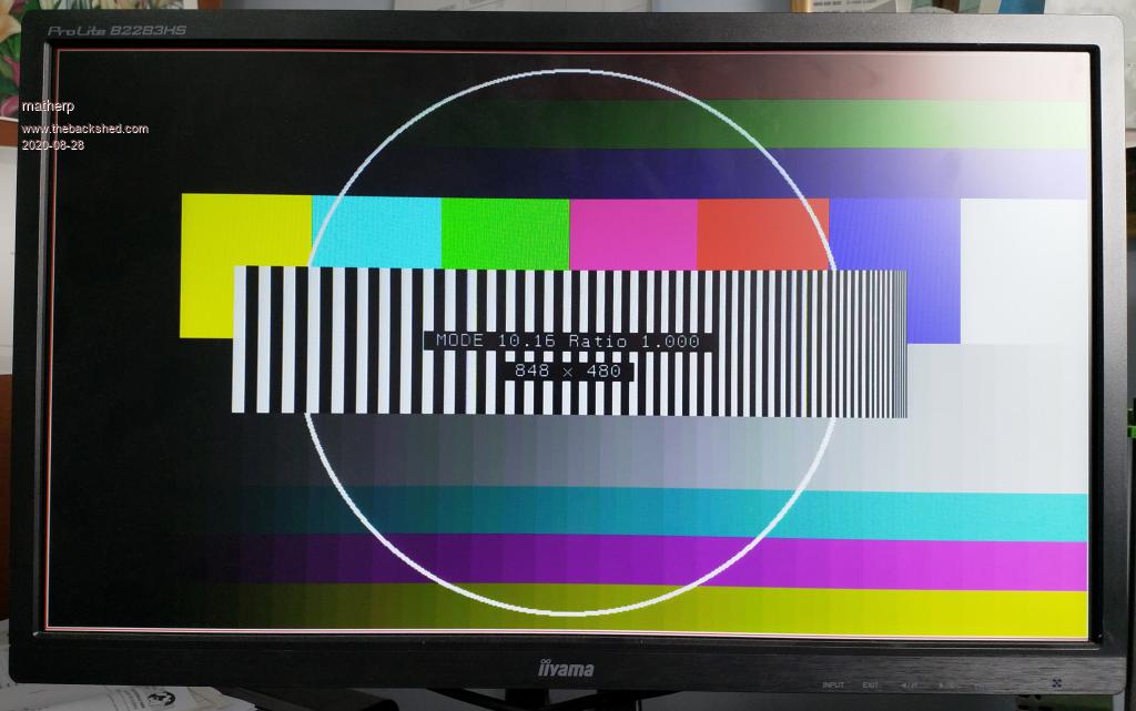

I've found a little known widescreen mode which is surprisingly  supported by nearly all widescreen monitors 848x640@60Hz and is within the capabilities of the CMM2. Apparently this was the first widescreen mode way back when.
This is now available in V5.05.05b21 as mode 10. It can also be used as the default mode
OPTION DEFAULT MODE 10
This will fill a widescreen monitor with square pixels and has almost exactly the same aspect ratio as 1080p.
If you have a widescreen monitor with a VGA input please try it. I have no idea if it will work through a HDMI adapter
This mode should not be used for programs to be distributed as not all users may be able to show it, but it is excellent for editing when you have a widescreen monitor.
NB: OPTION DEFAULT MODE is now preserved when updating firmware.

Posts: 6626
Posted: 12:03am 28 Aug 2020
The widescreen mode 10 works well on my monitor but the monitor doesn't switch between wide and normal modes easily, so I think I will spend most of the time in mode 1 or 9
Posts: 2982
Posted: 02:41am 28 Aug 2020
It works well for me too Peter!
It took about 10s for the auto sync on the monitor to stop adjusting but after that it looks great
