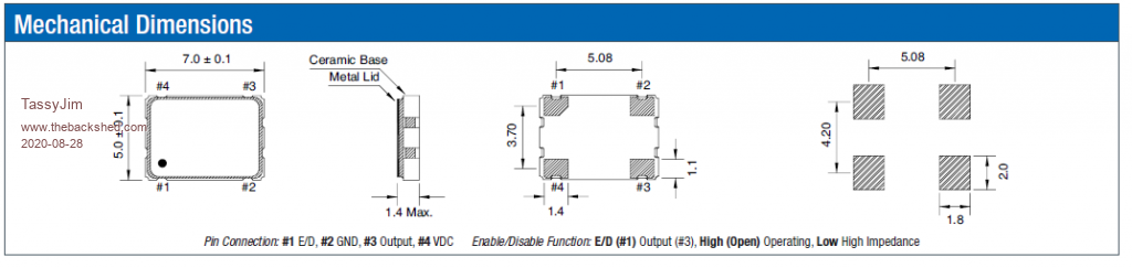

  Quote  The latest PCB has provision for an external 8 MHz crystal oscillator to replace the 8 MHz crystal on the
Waveshare CPU board. This may be needed in some rare cases where a monitor has difficulty with some VGA
modes (such as 800x600 pixel 16-bit colour).
Most people will not need this mod however, if it is required, it can be implemented by removing the 8 MHz
crystal on the Waveshare CPU board and installing the external oscillator and a capacitor on the motherboard.
The parts required are:
1 SMD 1206 100nF ceramic capacitor
1 8MHz oscillator in 5.0 x 7.0 mm SMD package (QX7 XO 25ppm). Eg, RS Stock Nbr 813-6194 .
I mounted mine dead bug style on the Waveshare module but current mainboards have provision for it there which is much neater.

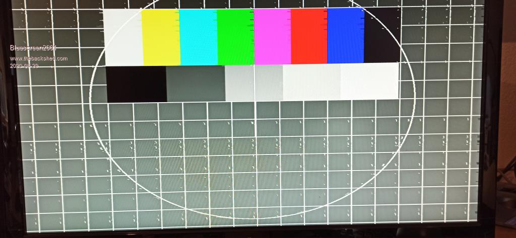

Since I have no oscillator on hand, I first tried to change the crystal and both of it's capacitors. But that didn't help.
This is mode 9:
In the default mode the flickering is only ocassionally, so I can live with it for now.
I have to wait until I have a few more parts to order. 0,90€ plus 6€ shipping is too unefficient.

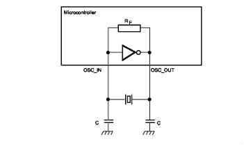

Posts: 2528
Posted: 04:43pm 08 Sep 2020
the problem is not the crystal itself, but the nature of the circuitry (within the H7 processor) that drives it:
while the OSC_OUT pin is a low-impedance output, the OSC_IN pin is a high-impedance input. on the waveshare module this pin is not only attached to the crystal, but also runs to a pin on the edge of the module's PCB. this acts like a little antenna that picks up signals from other traces that run near to it on the module. in particular, traces that have high-speed clock signals for the RAM chip located on the underside of the module.
the signals that are picked up by the 'antenna' attached to the OSC_IN pin interfere with the smooth/stable running of the crystal oscillator circuitry, randomly trying to pull the oscillator off-frequency ever so slightly, resulting in tiny glitches in the VGA output.
the folks who designed the waveshare module really should have considered this, and employed a better layout to avoid the possibility of having stray signals coupled into the OSC_IN pin.
when you add an external crystal module, this provides a low-impedance output that drives into the OSC_IN pin on the processor. because the source is low-impedance, signals from nearby traces are no longer able to interfere.
