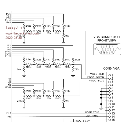

I have not been able to see the RED part of the RGB for VGA connection.  Am just seeing variations of blue and green colors with a black background.  This is the case when connected to a Samsung 50 inch Plasma tv and also when connected to an ASUS VN279 monitor.
Has anyone had this or a similar issue?

Most likely point of failure is
Your cable
Socket where it's soldered onto the board.
Shorted 75 ohm resistor
Short or open circuit trace from socket to resistor networks.
The pins on the CPU are not likely because there are 5 and failure of all is not plausible.

Hi ,
I think it's really not possible to not solder ALL resistors from the Red R2R DAC part.
So i recommend you to check the soldering point on the pin 1 from your VGA connector.

Hi Bar1010, All,
If you think your cable and monitor are ok, tested on another device, I can see only 2 possibilities.
As mentioned check pin 1 on the vga connector for damage (looking into the socket) or bad soldering.
The only other thing I can see is an incorrect value of the 75R that connects pin 1 to GND. It might be too low.
Use a multimeter and measure the resistance between pin 1 of the vga connector and GND .. it should be close to 75ohm..  if it is near zero then something is wrong, either a short (solder splash) (look very closely at the connector) there are GNDs near the pin 1..

Type CLS RGB(RED) and you should measure around 0.7V on pin 1. If that looks OK then it is the cable

As it turns out my VGA to VGA cable was bad.  Received a replacement cable today and now the Red color appears on the intro screen along with the other correct colors.  Thanks a lot for the ideas.
