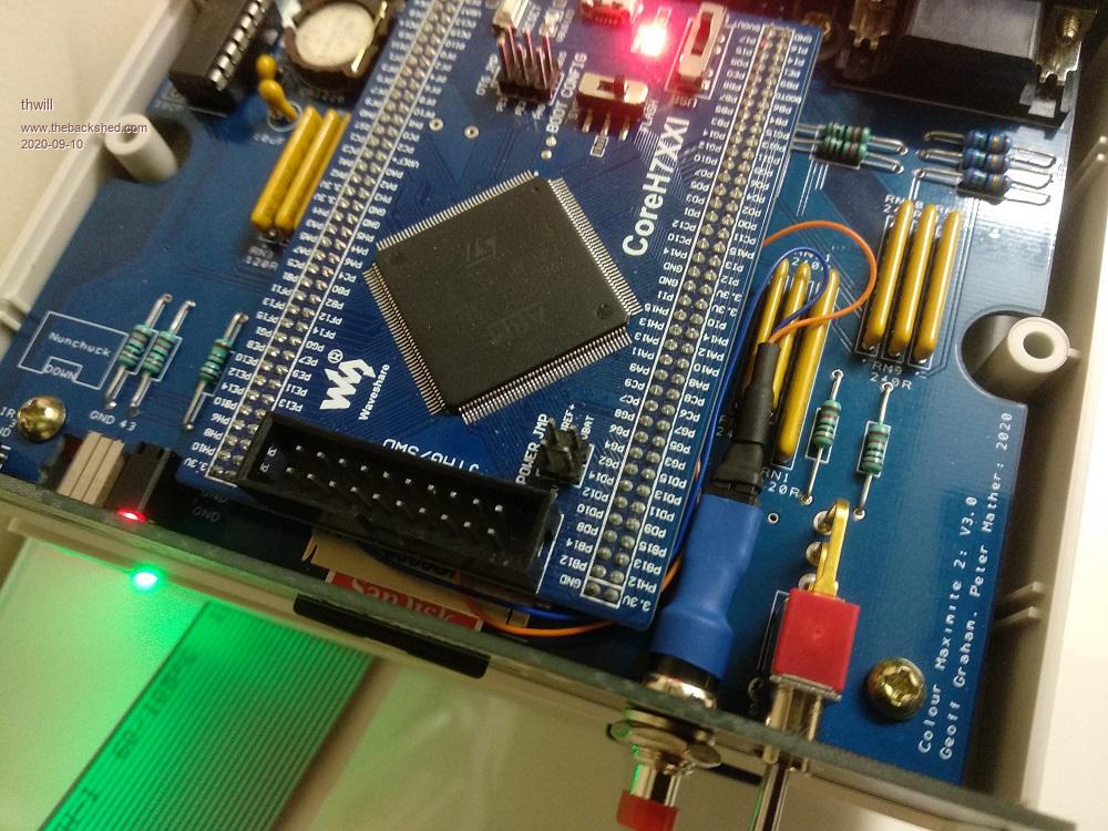

Hi folks,
My CMM2 has been "open top" since I got it, but with the imminent arrival of front and back panels I'm intending to case it up.
However I've got used to using the Waveshare's reset button when I update the firmware and to clear it when it hangs, unlike the main power toggle it doesn't cause Putty to disconnect.
Is there anything more elegant and mechanically less fragile that I can do as an alternative to soldering a couple of wires either side of the reset button and connecting them to a push button on the front panel? Is what I'm suggesting inadvisable? Why?

Connect between the reset pin on the 80-pin header and GND

  matherp said  Connect between the reset pin on the 80-pin header and GND
Thank you Peter, looks like there is something a "bit" more substantial to solder onto there.
Posts: 2552
Posted: 01:20pm 04 Sep 2020
looks like you could also wire your reset switch between pins 15 (-RESET) and 16 (GND) of the JTAG connector on the waveshare module:
to avoid any soldering, you may be able to plug a 2-pin berg connector into here, provided there is enough clearance with the top of the case in place.
rob   :-)
Edited 2020-09-04 23:21 by robert.rozee
Posts: 4398
Posted: 02:15pm 04 Sep 2020
Thanks Rob,
There is no clearance to connect anything to the JTAG unless I solder a lead directly to it ... but there is a decent blob of solder on the underside of pin 15 so maybe I can attach to that ... don't really fancy trying to release those two 80-pin headers and remove the waveshare board though, I can be such a klutz.

Posts: 4398
Posted: 07:31am 05 Sep 2020
  Andrew_G said  I just drilled a 2.5mm hole directly above the push-button. An up-market wooden toothpick does the job for me.
Thanks Andrew. Sounds like a good way for me to end up with a case that looks like Swiss Cheese. My motto is "Measure three times, and then still cock it up."
I've found the Waveshare is not as difficult to remove as I feared, so once I've checked that the reset works I'm just going to solder the leads to the underside of the JTAG.
Posts: 4398
Posted: 03:24pm 09 Sep 2020
Despite my ample lack of talent I don't appear to have cocked it up, thanks for the advice folks.

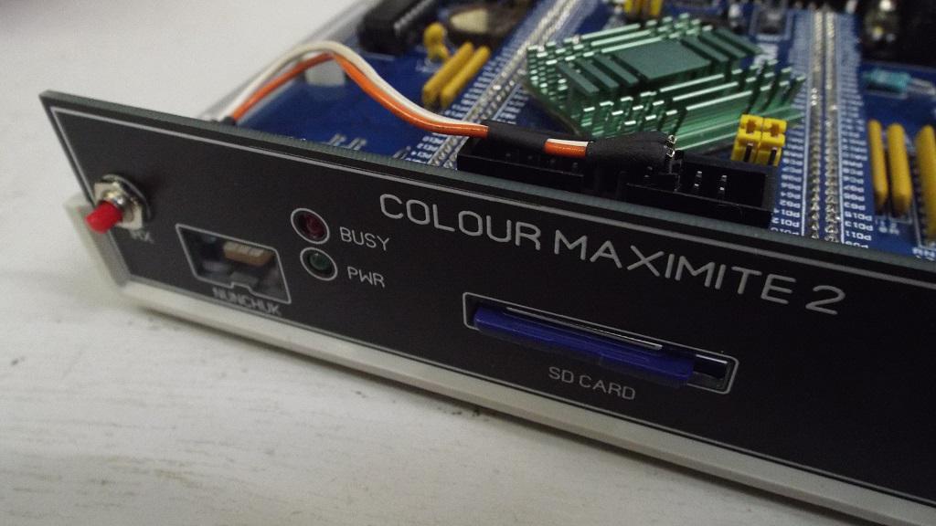

Posted: 07:36pm 18 Sep 2020
Thanks for the info Peter and Rob
This is one mod I'm definitely going to implement.  I have also been running my machine open to use the reset button.
This will also be of great use for people building their CMM2 into a custom case.

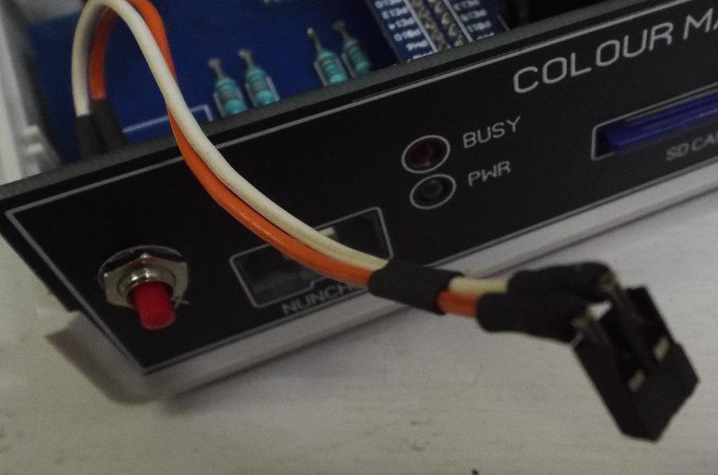

Edit:Cut Down an old PC Reset Switch 2pin DuPont housing, bent the cripmed ends, and insulated them with heatshrink tube.
This will then fit into the JTAG connector on the Wavesharre board, without fouling on the case.
Its a tight squeeze, and you may ruin a few crimps to get it right.
Soldered on a small push to make switch from my parts box and fitted it in the IRX hole in the front panel.
The Case Lid Fits - just
Edited 2020-09-24 04:12 by Womble

Posted: 06:17pm 23 Sep 2020
Reset Mod complete, see post above.
Managed to do this in an non-destructive way

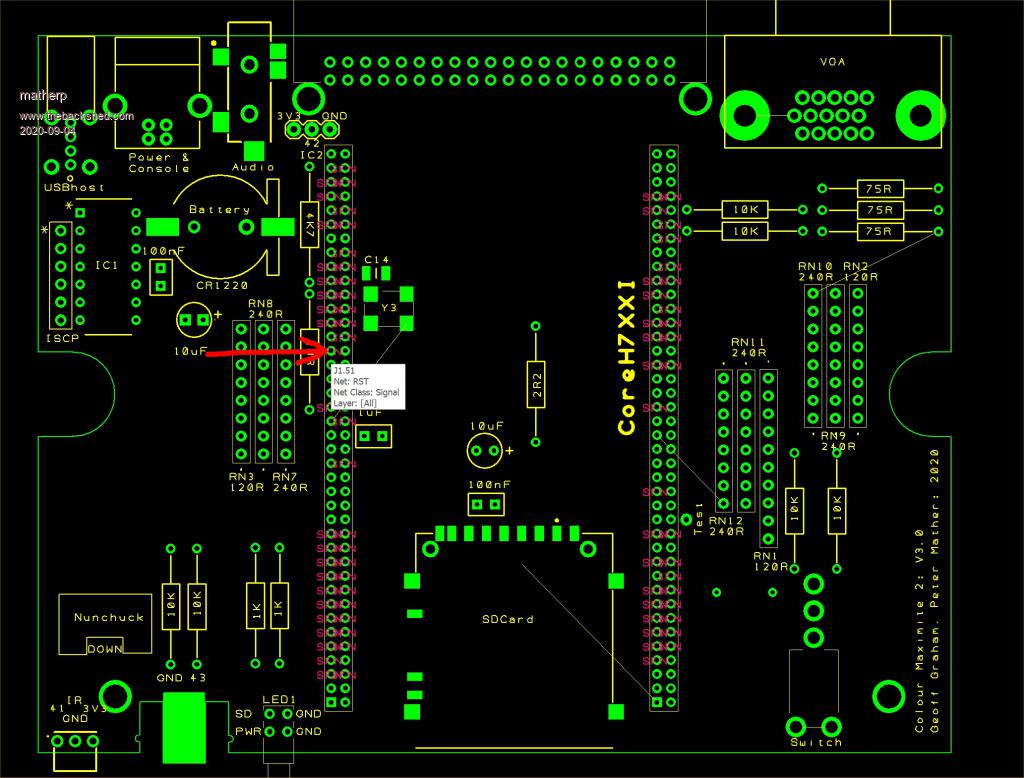

Any Idea how to get a reset switch on a fully assembled NONE waveshare units?

  mclout999 said  Any Idea how to get a reset switch on a fully assembled NONE waveshare units?
Looking at the photographs on CircuitGizmos website there appears to be a surface mount reset switch near to the VGA connector.  Not sure if the Micromite.org prebuilt CMM2 has this.  I only have Waveshare based boards.
If this is a reset button, you could drill a hole in the case above it and fabricate/3dprint a button to access this switch.  Suggest you pop the lid off of your CMM2 and take a look.

Posts: 11882
Posted: 07:30am 24 Sep 2020
  Quote   was asking about a wiring option like they where showing for the waveshare version
RESET is pin 5 of the ST-LINK header, Gnd is pin 3, Pin 1 has a star next to it

Posted: 07:37am 24 Sep 2020
There's a reset line in that ST-LINK header, isn't there? Maybe pin 5? Plus a ground on pin 3? Switch between them should do the trick. Research more before letting the smoke out!

  mclout999 said  I DON'T have the waveshare version.  I have the fully assembled one
The fully assembled one has the ST-LINK header, which is different from the debug header on the Waveshare version.
The ST-LINK header is on the left edge, just behind the IR receiver.
