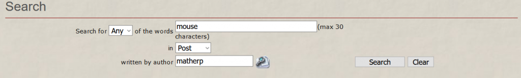

However
I did the following search ...
and found this post ...
  matherp said
  Quote  which has a mouse functionality, and it works fine, surprisingly!
There are some that do because they don't implement the "mouse" via a hub, or the keyboard somehow bypasses the hub, seems to be specifically some type of cheap wireless, but the advice has to be don't buy and expect to work a keyboard with hub or mouse functionality.
