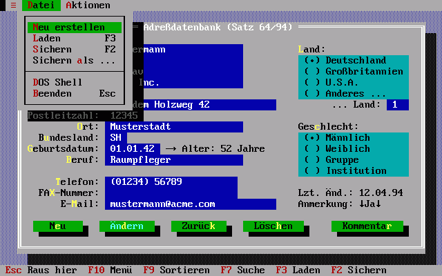

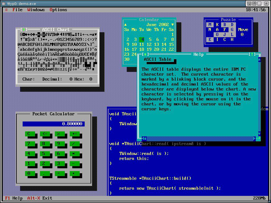

I'm very fond of this idea. A TUI would be a good feature of the CMM2. It would have been great if TUI could have been a keyword and the functionality included in the firmware, but there are no remaining tokens. But it is still very doable as a CSUB.
I know that games and whatnot use the great graphics capabilities of this fine machine and that a text interface may seem like a step back. But a well-written TUI would be great for education and utilities.
I've tried to find on-line resources for... ready for this?... Visual Basic for DOS to see what that development environment had to offer. I was hoping to find a pdf of the VB for DOS book. It would have all of the elements such as input fields, labels, buttons, checkmark boxes, message boxes, etc. (Note that the default font of the CMM2 has all of the box-draw characters.)
A TUI CSUB would grant the programmer the ability to be able to interact with the program user in a way that is several steps better than just a single INPUT command line entry at-a-time.

Posted: 08:04pm 17 Sep 2020
  William33 said  Sorry, but would it useful without a mouse?
Those old TUIs were designed to work without a mouse.
You either tabbed or arrowed around until you reached the target widget, or you used a shortcut key - note in the first screenshot every screen item has a unique letter in red or yellow, which is the keystroke associated with it.
Typical Windows BIOS configuration screens are an artifact of this keyboard-only UI method.

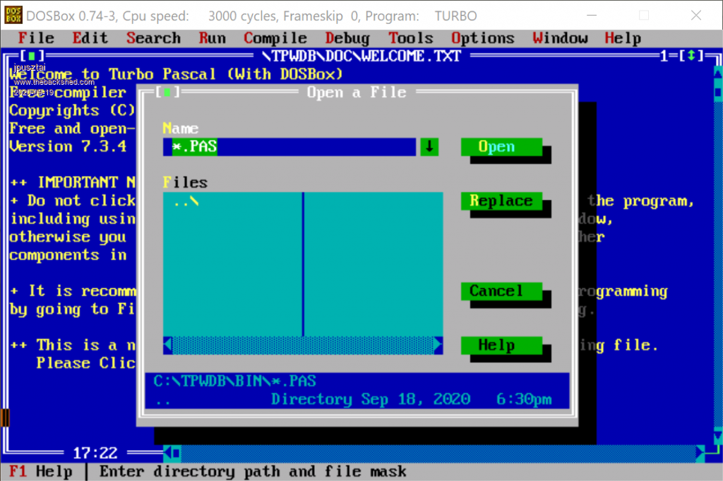

  lizby said   Also enabled me to run TurboC--TCC.EXE dated 1988. Oh the thrills.
Apropos this TUI thread, and various other ones about MMBasic’s text editor, I have very fond memories of the TurboPascal package and its built-in editor. I ended up using that Turbo editor to edit everything - it was vastly superior to any of the “default” CP/M and DOS editors at the time.
Feels like a DOSBOX kinda weekend coming up :)
