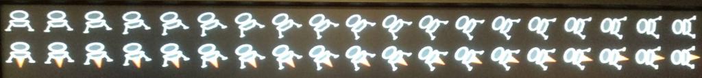

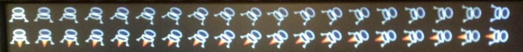

OK Peter, here is a reduced example, I guess reproducing CMM2 firmware bugs is more interesting than the day job.
lunar.zip
1. Reset CMM2
2. RUN "lunar.bas"
3. Output is:
4. EDIT "lunar.bas"
5. F2
6. Output is:
Not only is the rotation "wrong", but the colours of the sprites are slightly different too.
And before you say anything it's @vegipete's weird code, not mine , and either way I would expect it to be weird and consistent, not weird and inconsistent.
Edited 2020-10-30 00:24 by thwill
Posts: 11882
Posted: 03:13pm 29 Oct 2020
Perfect: found and fixed
