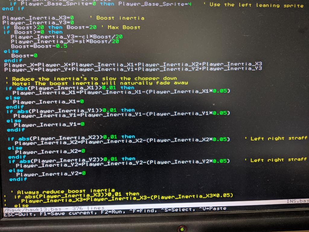

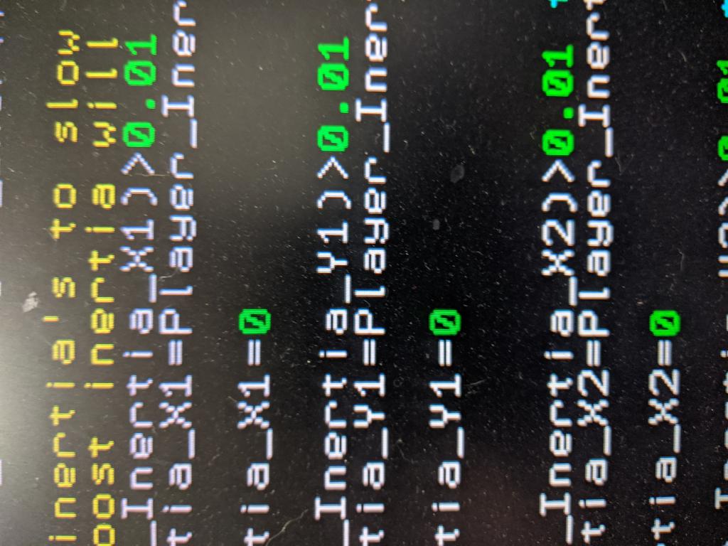

I thought I was super clever and dug out my Samsung 213T(1600x1200) monitor that I had been saving for years just on the off chance that 4:3 screens would come back. It does work great, but to be honest, the image also looks great on my old 1920x1080 BenQ monitor.
I know the uneven pixels must be there, but I can't see them, even when I look really closely (full disclosure - my eyes are failing a bit). I have taken some screen shots of the monitor to show you (please ignore the bad code). But I suspect you will be absolutely fine with any old 1080p monitor. (Although I've only tried the one 1080p monitor).
