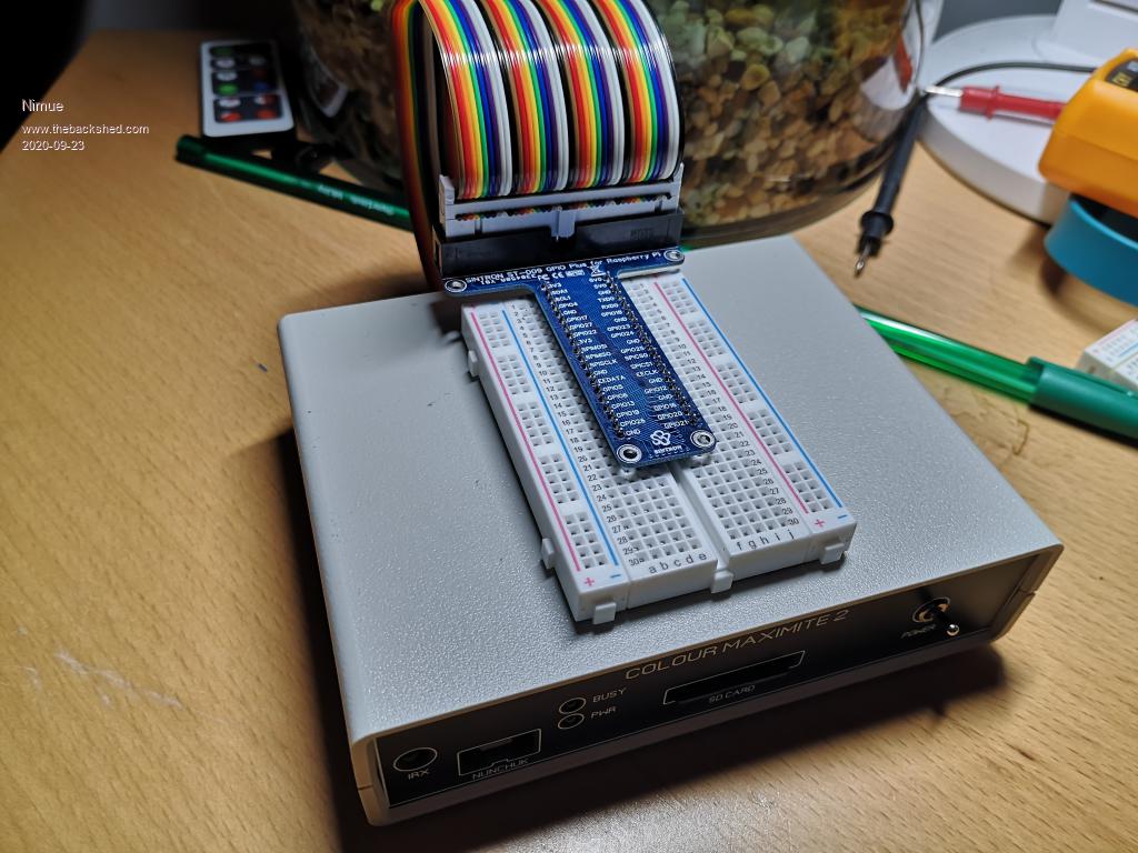

I use my CMM2 with a ribbon to breadboard adapter (a Ras PII one).  As per the manual, I needed to manually "adjust" the keyway so that ribbon cable pin outs match the CMM2.
All good stuff - and works a treat. See image below.

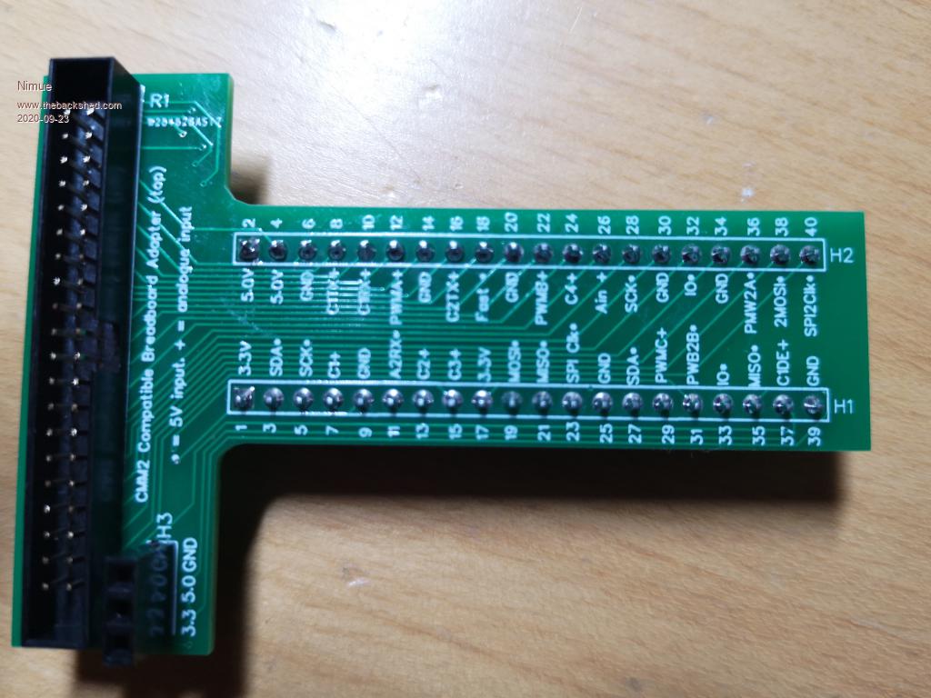

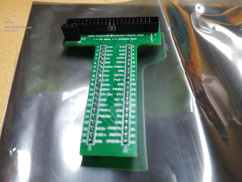

However, as the labelling of the pins is Pii specific and I didn't like the fact of hacking the IDC header.  So I fired up EasyEDA, and designed a new one... I sent the finished PCB to PCBWay and 8 days later x10 of these beauties arrived:
All lovely silk printed and with the IDC header on the right way round..
But in my haste, I designed using a 2mm pitch IDC header as opposed to 2.54mm pitch.  So -- I need a "solution" or "fudge" take your pick...
Option 1:  Ribbon cable with 2.54mm and 2.00mm headers (not sure this will work due to the different pitches - I presume I would need to use 2.00mm ribbon cable)
Option 2:  Design and manufacture a 2.54mm male socket into a 2.00 female socket adapter - not difficult -- to keep the cost down, I would probably need to solder them myself -- but will see what PCB Way will cost
Option 3:  Buy something -- but not sure what.  Cant find a 2.00 to 2.54mm ribbon cable but that would be ideal.
I have x10 of them to find a home for....

Massive kludge, but you could use Dupint Ribbon Cable and connect the dupont connectors to the pins on your adapter and use a vice to fit an ide connector on the other end.
Fiddly to setup, but would work.
If its for the kids to use, hotglue the dupont end in place so they cannot screw up the connections.
This video shows how you install idc connectors onto ribbon cable.  You can carefully disassemble an old IDE cable to savage the connector.
This technique can be used to reverse the connector on your Pi adapter cable.

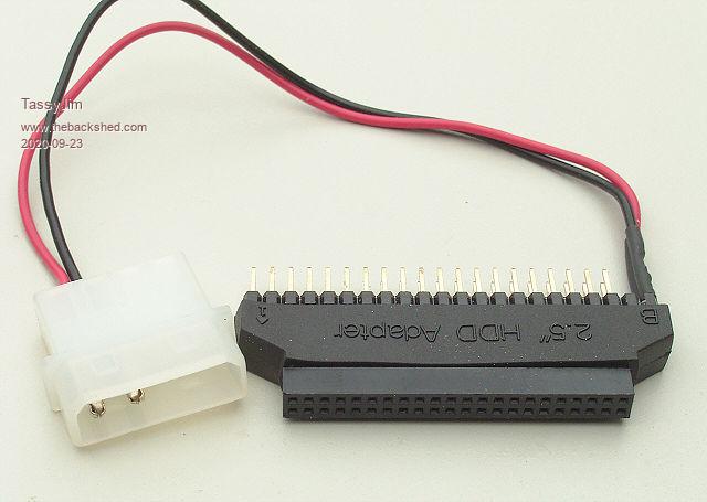

Back in the distant past when HDDs were IDE, we had 2.5 to 3.5 IDE adapters.
You would have to remove  some of the pins on the 2.5 side (or get a bigger hammer).
They would probable cost more that getting new boards made...
Some of them have a pin missing supposedly for keying but I am sure it's just to annoy us.

Nimue ...
Check the pitch before buying dupont cables.  I think the ones I linked above were 2.54mm.
These are 2.54mm (1P) on one end, and 2mm (2P) on the other
As Jim mentioned 2.5" to 3.5" IDE adapters might solve your problem, something like this.  Some work with a multimeter to check the connections would be necessary in case some pins are not connected, or ar tied together.
However Jim is right, it might be better to get a v2 done by PCBWay with the correct connector unless you are in a hurry.

Might be cheaper to order just V2 pcb's and a bag of pin header strips in the correct pitch and solder them yourself.
You don't need to use a housing on the ribbon cable connection, although it does help to avoid plugging it in the wrong way round.  Thats why IDE cables often have a blanked off pin.
Bare pcb's should be cheaper.
A blob of hot glue will stop mischevious kids reversing the cable.
