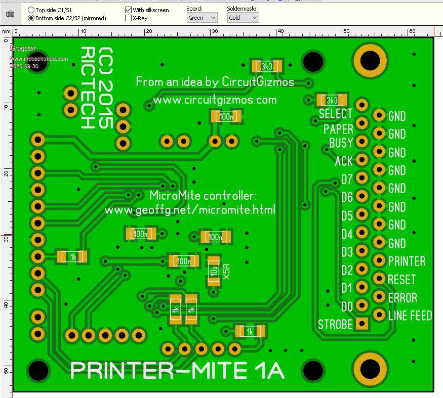

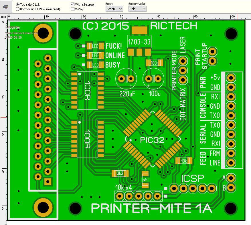

Posts: 10043
Posted: 04:53am 30 Sep 2020
Did that a few years ago.
That PCB was designed specifically to buffer data to either a dot-matrix or laser printer, with a parallel port.  I never got around to testing/writing code for it to use with laser printers though.
Posts: 2981
Posted: 05:34am 30 Sep 2020
Grogs,
I love the top LED..
Mik
Posts: 10043
Posted: 07:41am 30 Sep 2020
Opps....
Sorry Gizmo.
I just posted the image, but did not really bother to check it for that, as I never - usually - silkscreen like that! (I think this is the only one)
It is an "Error!" LED, really, but whenever we make a mistake, we generally verbalize our frustration at our own mistake using that word.
