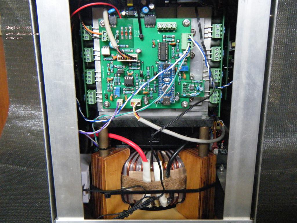

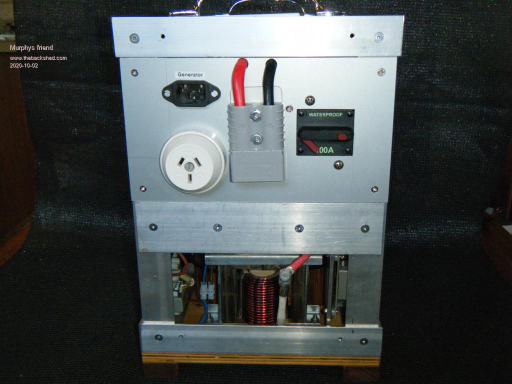

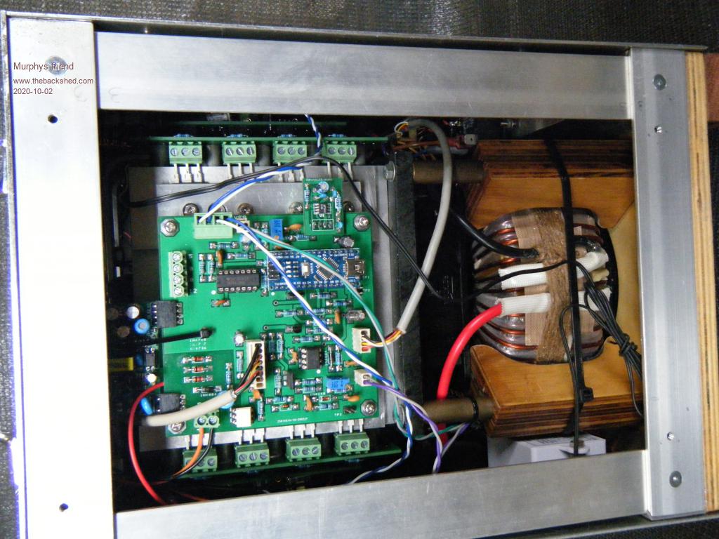

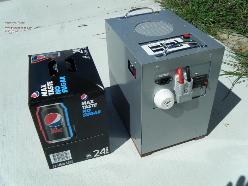

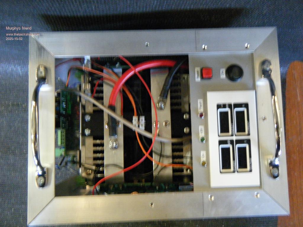

So I thought I build an inverter for my caravan, 24V system.
It had to be portable, only used for that long trip with lots of free camping.
This is what I came up with, the 24 can drink box is for size comparison.
It was built completely from ideas seen on posts in this forum.
My thanks go to wiseguy who kindly posted a schematic for  the driver & final power stages.
Also to poida for publishing his nano inverter progam, I made my own PCB (100x100mm) for this control board.
Lastly to warpspeed for his very clever opto isolated idea.

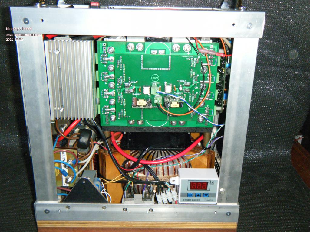

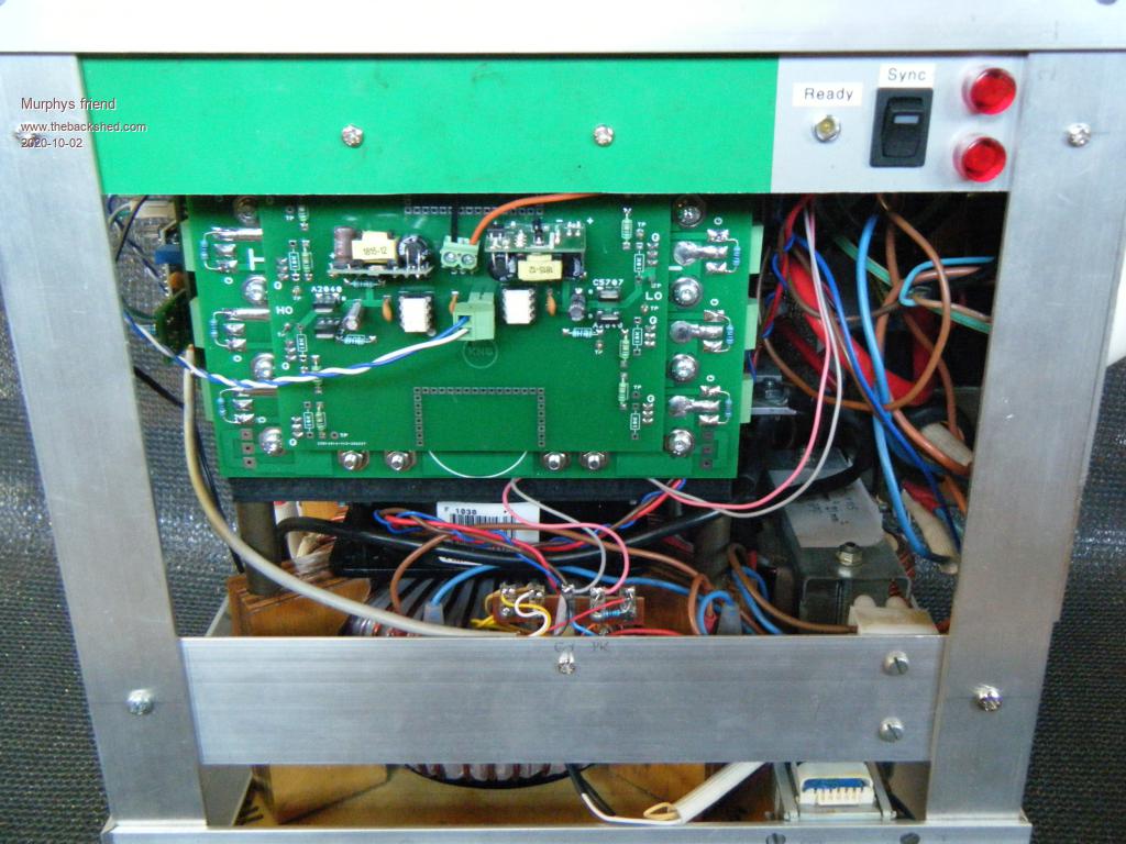

The inverter uses a toroid salvaged from a 1.5Kw Latronics inverter, I left the original secondary in situ and re wound the 96V primary so it can now be connected to a nominal 24v or 48v battery.
The fully opto isolated output uses a DC-DC up converter to supply 50V to the little 15v isolated power modules as they won't start reliably on 24V.
The output stage has a totem pole final drive.
The inverter uses 16 HY4008's, and 60,000uF of capacitors.
The idea was to connect it in sync to my  generator as the genny (1800VA cont, 2200 peak) won't run the A/c in my caravan.
Here are a few pictures what it looks like:

A lovely build, congratulations Murphy,s,(whoever he is)lol.,
You have made a very Robust unit, having no caravan experience, but my brothers have gone around Oz a few times ,and discovered that your robust construction is the only way to stop disasters on the rough dirt roads, .
Nice that you posted the pics, gives us all good ideas, thanks.

I can see a lot of time and effort gone into arranging components to fit in neatly and work nicely.
Nice to see another successful inverter build.

Oh, before I forget wiseguy's question, the inverters enclosure was built from scratch to fit exactly what's inside, got pretty crammed full as shown in the pictures. I have since removed the sync relay parts & mounting brackets so the inverter PCB's are more accessible now.
