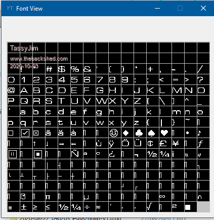

Posts: 6626
Posted: 09:21pm 02 Oct 2020
Under the assumption that you are using FontTweak, not Tweakfont...
I assume you started with the '.c' file.
The header line is not consistent with the data.
The header suggests 16 characters starting at chr$(0) but the data has the full 256 characters. We can't do 256 so 255 is the closest.
As your 'c' file font has the first 32 characters as blanks, you would end up with a font of 16 space characters. This is what did happen when I tried it.
Once that was fixed, the '.c' file loaded. Still complained, but loaded OK.
Changing the header to 255 gave me 255 characters as expected.
I changed the start of the '.c' file to:
  Quote  fontdatatype Microgramma[15364] PROGMEM={
0x18,0x14,0x00,0xff,
From there, according to the help file
  Quote  Delete First Character (ctrl-Delete) removes the first character in the file.
You will have to do that 32 times.
Edited 2020-10-03 07:48 by TassyJim

Hi Jim, Thanks for your reply.
Yes I used your Fonttweak programm. I just explain what I did:
1. Opened your programm.
2. importet an ttf Font
3. selected CP_CMM2.inf
4. selected my font and loaded it.
5. marked the font from &h00 - &hff
6. Pressing space
now I got all characters in the fontview.
7. I save as .bas file
so as a stupid user or newbie I thought thats all i have to do
and when i now try to reload it only loads the 16 characters and thats all...
what I now have wished is that i simply store them and thats it...
I mean I wished a simple convert from one to another fileformat.
with not doing so much stuff between...
as a simple user I don't know that I can't use only 255 letters. I thought the programm only allowed as much as the new converted format will need... ot just won't store the last character i marked or gives an advice (Hey for a CMM2 Font you only can use 255 letters)
as a simple user I don't know that you can't put anything before char nr. 32
I would have loved that the programm simply erased them by itself or won't even allow to let them select this wrong option so the font would be unusefull...
see where I try to get ? Maybe you can change this to a simpler process so people don't need to do so much to convert a ttf to a colormaximite font. The programm is fantastic. I love that you can do your own characters with this. maybe just make it
a little bit easier for noobs like me ;-)
So knowing that you can't have marked all 256 (because 255+0 will be 256 I guess)
I will try now again...
1. open Programm
2. Import ttf (new window opens)
3. select "CP_CMM2.inf"
4. click font and import the ttf font.
5. Select from &h00 to &hfe (so this should be only 255 characters now)
6. press space
7. save as .bas
great now it loads again into the editor... now i have to erase all the 31 chars before char 32 (space) (Would be cool to have just a button or simply if you select "CP_Cmm2.inf" it won't import those characters and simply let it blank ?
and hope this then can be read in the colormaximite 2
I am no pro user like you gurus for you this is all simple... for me it's
all new and complicated. I try to learn as best as i can. (And hopefully don't get on your nerves with all my questions)
Please take this as constructive criticism ;-)
Thanks for your help and support. Its much appreciated and the programm is fantastic.
Cheers TweakerRay

Posted: 10:35am 12 Oct 2020
Not sure if you wanted suggestions, but:
Instead of
  Quote  5. Select from &h00 to &hfe (so this should be only 255 characters now)
you can select from &h20 to &hff, then you won't have to erase the initial 32 afterwards.
