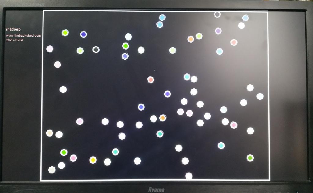

You will need to download V5.05.06b16 for this demo as it uses a couple of new SPRITE functions:
SPRITE(T,spriteno) ' returns a bitmap showing all the sprites currently in collision with the requested sprite. Bits 0-63 in the returned integer represent a current collision with sprites 1 to 64 respectively
SPRITE(E,spriteno) ' returns a bitmap showing which if any edges of the screen the sprite is in contact with:
 If sprite(E,spriteno) AND 1 Then
   'collision with left of screen
 Else If sprite(E,spriteno) AND 2 Then
   'collision with top of screen
 Else If sprite(E,spriteno) AND 4 Then
   'collision with right of screen
 Else If sprite(E,spriteno) AND 8 Then
   'collision with bottom of screen
In addition b16 fixes an issue with SPRITE HIDE ALL status not being cleared correctly
This demo hammers the SPRITE engine with 64 sprites moving all over the screen and never being allowed to overlap. Video here
option explicit
option default none
option console serial
mode 7
page write 1
'brownian motion demo using sprites
dim integer x(64),y(64),c(64)
dim float direction(64)
dim integer i,j,k, collision=0
dim string q$
for i=1 to 64
 direction(i)=rnd*360 'establish the starting direction for each atom
 c(i)=rgb(rnd*255,rnd*255,rnd*255) 'give each atom a colour
 circle 10,10,4,1,,rgb(white),c(i) 'draw the atom
 sprite read i,6,6,9,9 'read it in as a sprite
next i
cls
box 0,0,mm.hres,mm.vres
k=1
for i=mm.hres\9 to mm.hres\9*8 step mm.hres\9
 for j=mm.vres\9 to mm.vres\9*8 step mm.vres\9
   sprite show k,i,j,1
   x(k)=i
   y(k)=j
   vector k, direction(k), 0, x(k), y(k) 'load up the vector move
   k=k+1
 next j
next i
do
 for i=1 to 64
   vector i, direction(i), 1, x(i), y(i)
   sprite show safe i,x(i),y(i),1
   if sprite(S,i)<>-1 then
     break_collision i
   endif
 next i
 page copy 1 to 0
loop

Posts: 11882
Posted: 05:57pm 03 Oct 2020
  Quote  I remember a simulation I used years ago that did exactly this
Good
Any chance you can help by defining the correct equation for two atoms colliding and I'll include it as it is completely wrong at the moment.
I see a collision and know the velocity and direction of both atoms. I need to calculate the new velocity and direction for each of them. At the moment the velocity is always the same and they are assumed to be the same mass so that simplifies things.
Nimue
Joined: 06/08/2020
Posts: 449
Posted: 06:12pm 03 Oct 2020
Good
The ideal gas equation assumes:
(1) All point masses - ie radius is zero --- but we cant sim that.  The assumption we use is that total area of all the particles is small compared to the size of the box (1% ish)  -- but that is often overlooked when simming so that we can detect collisions
(2) That all particles have the same mass
(3) That all collisions are elastic - ie the total momentum before = momentum after (ie no energy is lost / the individual particles do not get warmer as they collide)
The kinetic energy (1/2 mv^2) is 3/2 x nRT  -- where R is a constant (approx 8) and n = number of moles (assume 1 for the sake of simulation) -- so KE =  12T  (where T is in Kelvin).
This gives mv^2 = 24T
v = SQRT (24T/m)
v is conserved during a collisions.
Pressure x Volume (in our case sub for area of box) = nRT (n=1, R=8) = 8T
Pressure on box = 8T/Volume (use area as 2D)   (assuming n=1)_
As you describe your assumptions should work out - don't think you need to alter them for this to be calculated...
Posts: 11882
Posted: 06:26pm 03 Oct 2020
Its the directions after the collision I'm struggling with
atom one of mass M is moving at speed V in direction theta1
atom two of mass M is moving at speed V in direction theta2
the atoms are assumed to be round and collide, I know the vector from the centre of atom1 to the centre of atom2
What is theta3 the new direction for atom 1 and theta4 the new direction for atom 2?
Edited 2020-10-04 04:27 by matherp

After nearly 3 hours running, it finally gave up with
  Quote  Error in Line 99: -9 is invalid (valid -8 to 239)
Posts: 11882
Posted: 07:51am 04 Oct 2020
  Quote  After nearly 3 hours running, it finally gave up with
Oops missed a bracket
  x(atom)=rnd*(mm.hres-sprite(w,atom))
  y(atom)=rnd*(mm.vres-sprite(h,atom))
Also change line 33
  sprite show i,x(i),y(i),1
