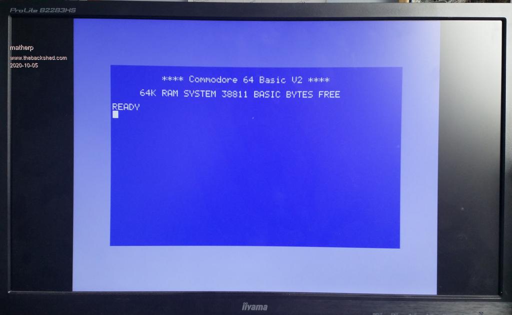

Nearest I can get is 400x300 which has been requested before so I will include in the next beta
mode 13
cls rgb(128,128,255)
box 40,50,320,200,,rgb(blue),rgb(blue)
print @(96,60,1)"**** Commodore 64 Basic V2 ****"
print @(72,76,1)"64K RAM SYSTEM 38811 BASIC BYTES FREE"
print @(42,92,1)"READY"
box 42,100,mm.info(fontwidth),mm.info(fontheight),,rgb(white),rgb(white)
do:loop

Hi Peter,
that's also good, it will look very well...
Thanks!
