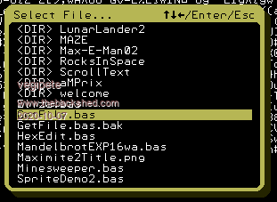

There has been a nice collection of utility programs created in the last little while but one aspect of them has put me off.
You type run, and the program asks:
Enter file name:
I'm expected to know the file name, and type it in? Are you mad? What is this, the 70s?
Here is my solution:
The GetFileName function should be very easy to add to programs, lets the user select a file from those on the SD card, traversing directories in the process, and returns the full path of the selected file in a string. (An empty string indicates Cancel.)
The number of lines of files shown in the dialog is set in the function call. Many other aspects can be altered easily in the code. The dialog box respects whatever is on screen before hand and redraws the pre-existing image when it quits.
There is a short demo program to show it off. The demo program uses MODE 1,8 but other modes should work just as well - it needs a horizontal resolution of at least 300 pixels so modes 5 and 6 might look chopped.
Give it a try, and use it yourself if it's helpful. Let me know about problems, or requests or whatever.

' Function GetFileName(height,spec$)
'   version 1.0          vegipete, Oct 2020
' This funtion displays a centered dialog box on the screen, allows
' the user to choose a file and returns the full path of the chosen
' file. The underlying screen is restored when the dialog closes.
' UP and DOWN arrows to select, ENTER to choose selection
' ESC to cancel, LEFT arrow to go up directory
' Input:  height: number of directory items to list vertically
'         spec$: currently unused, hopefully later it will allow file filtering
' Output: string containing full path of file chosen, or "" if nothing
'         Note: the directory part of the path will be capitalized. This is just
'         how the CWD$ function works. Fortunately, MMBasic is case insensitive.

Posts: 6606
Posted: 06:03am 07 Oct 2020
I like it.
Now to add my mouse wheel for selection...
I wish I had read the code before I ran it. A screen full of garbage was a surprise!

Two functions, a couple of globals and one line added to give me mouse wheel selection:

Nice work Pete, I can see this or derivations of it appearing in many future contributions.
epsilon
Joined: 30/07/2020

I haven't played with it yet. Is there an option to create new files?

  vegipete said  There has been a nice collection of utility programs created in the last little while but one aspect of them has put me off.
Enter file name:
Thank you - couldn't agree more in fact, it was on the list for every project I've got in progress right now.

@Pete
I changed the demo text to:
for i = 1 to 100:PRINT "The quick brown fox jumps over the lazy dog";:next
I think that looks better, less confusing.
Can you change the code to have folder names only? It would be useful to improve the epsilons archive program (MAR).
Kind regards
Michael

vegipete
Joined: 29/01/2013
Posts: 1185
Posted: 06:19pm 08 Oct 2020
I guess that wall of random characters as a backdrop to the dialog box is a bit frightening. I'll make an improvement.
Showing directory names only seems reasonable. I guess I have to make the spec$ work. Then setting spec$ = "DIR" would display only directories.
Returning a directory name instead of entering a directory would certainly be useful. Then for example, a hex file editor could directly edit a directory - dangerous, but possible. But something would have to change. Perhaps [Enter] returns the selected item and [->] (right arrow) tunnels deeper into the selected sub-directory? But then, since [<-] backs out one directory, perhaps the item <..> is unnecessary? What do people think?

Joined: 02/06/2014
Posts: 1772
Posted: 08:13pm 08 Oct 2020
  vegipete said  I guess that wall of random characters as a backdrop to the dialog box is a bit frightening. I'll make an improvement.
You could also take a look at the "Lorem ipsum" texts.
  vegipete said  Showing directory names only seems reasonable. I guess I have to make the spec$ work. Then setting spec$ = "DIR" would display only directories.
spec$ = "DIR" doesn't sound like the best idea (IMHO, sorry!). I would use a 3rd optional parameter.
Best regards
Michael
It is great work, but spec does sound like a file/dir spec.  Intuitively *.TXT means anything that matches irrespective of directory or file.  Directories only I think is a lot closer to an attribute switch (does the CMM2 support read only, hidden and all that stuff  ?).  Maybe I'm overthinking.
twofingers
Joined: 02/06/2014
Posts: 1772
Posted: 08:59pm 08 Oct 2020
@Pete,
I think "<DIR>" would be a option to use. You can have a folder named "DIR" but not "<DIR>" (The path name format is invalid).
Michael

vegipete
Joined: 29/01/2013
Posts: 1185
Posted: 09:15pm 08 Oct 2020
If you are selecting a directory, does it matter if you can see the files that are already in that directory?
What if I made the top item <Here>, meaning select the current directory?
Posts: 6606
Posted: 09:38pm 08 Oct 2020
  vegipete said  If you are selecting a directory, does it matter if you can see the files that are already in that directory?
current directory has traditionally been a single dot. "."

twofingers
Joined: 02/06/2014
Posts: 1772
Posted: 12:47am 09 Oct 2020
@Pete
Maybe Ruben (epsilon) should answer this, but I (IMHO) would say it should show ALL files AND directories, but only directories can be selected.
A functionality like DOS "Dir /AD" is also useful.
  vegipete said  What if I made the top item <Here>, meaning select the current directory?
Not a bad idea - I like it-, but a non-standard way of doing it. I would think that picking the directory from the next higher level is good enough. That would mean that the function remains unchanged, but only directories can be selected if the name is displayed and explicitly selected. In the sense of keeping things foolproof.
Just my 2c! Maybe we should read the opinions of others about it.

vegipete
Joined: 29/01/2013
Posts: 1185
Posted: 08:06am 09 Oct 2020
Here is a changed version.
The arrow keys move the selection around. Left arrow goes up a directory. Right arrow enters a directory. [Enter] selects the highlighted item (directory or file) [Esc] cancels.
There is a bit more fiddling to do, but please test this for usability and clarity.
Also, I made the background perhaps less alarming than a wall of random characters. (Unless you are afraid of bees.)
GetFile11.zip
twofingers
Joined: 02/06/2014
Posts: 1772
Posted: 09:23am 09 Oct 2020
Hi Pete,
The background of the v1.1 looks much better now!
.. and I'm not a drone!
Choosing a directory now works as required, but I would prefer a filename blocking option. I think the GetFileName function should have a parameter to make only folders selectable.
Thank you for your work so far!
