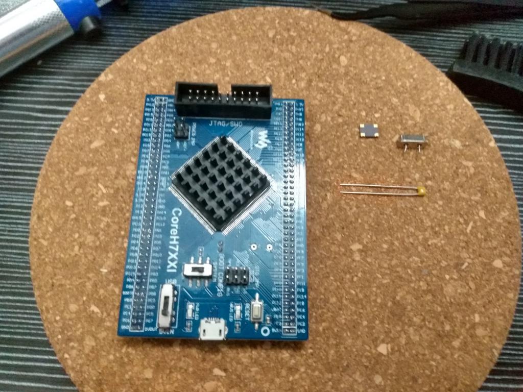

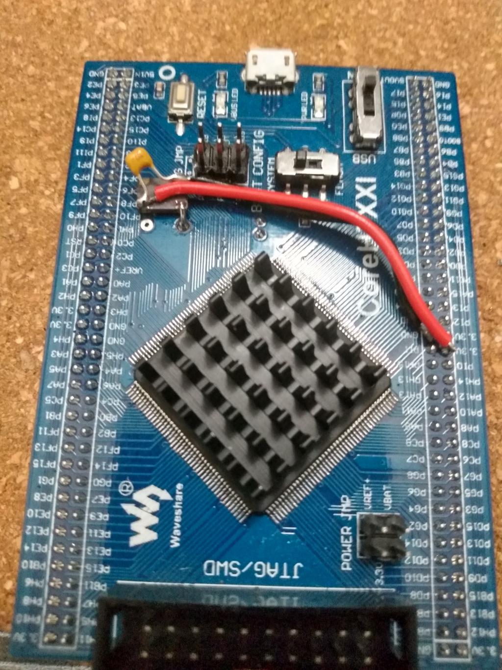

Is your CMM2 a single board one or with the Waveshare module?
If Waveshare, doing the oscillator mod should help the noise you are seeing.
It might also fix the main problem but I haven't seen one that bad.
I am surprised you are having trouble with so many modes.
Have you tried a different USB cable? It does look like a power supply issue and your 3A charger should be adequate but cables are often the cause of problems.
Many monitors have a facility for seeing the incoming video mode.
On my monitor it is under the Information menu item.
LeoNicolas
Joined: 07/10/2020
Posts: 625
Posted: 02:21am 13 Oct 2020
It's the Waveshare module.
Do you have the link for the oscillator mod?
Posts: 6606
Posted: 06:35am 13 Oct 2020
https://www.thebackshed.com/forum/ViewTopic.php?TID=12506&PID=153775#153775#152068

Hey
I've ordered the capacitor and crystal.
When they arrive I'll make the mod and check if will solve the problem :D
I'll let you know when I complete the tests with the mod.
Thank you for all you help
LeoNicolas
Joined: 07/10/2020
Posts: 625
Posted: 03:11am 21 Oct 2020
Thank you for all your help.
Problem 100% fixed, all modes working perfectly.
