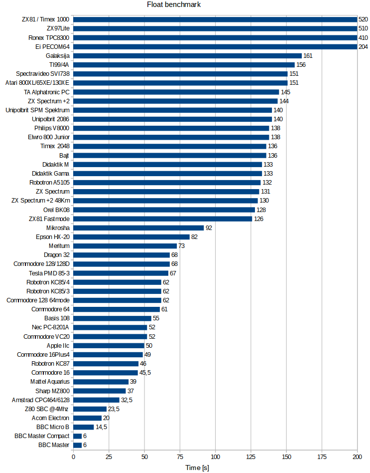

Somebody recently pointed me in the direction of this benchmark:
http://oldcomputer.info/8bit/benchmarks/index.htm
I'm away from computer so haven't had time to try it out, but I wonder how CMM1 and CMM2 would do?

Okay, let's see...
I have TI99/4As,
a ZX Spectrum +2, a +3, and a Harlequin ZX,
Commodore 64s, 128s, and VIC20s,
Mattel Aquariuses (happy to see this oft-maligned computer do so well),
an Acorn Electron and a BBC Micro B.
But where are the MSX computers? I may have to bust out my MSX TurboR and see what it will do. :)

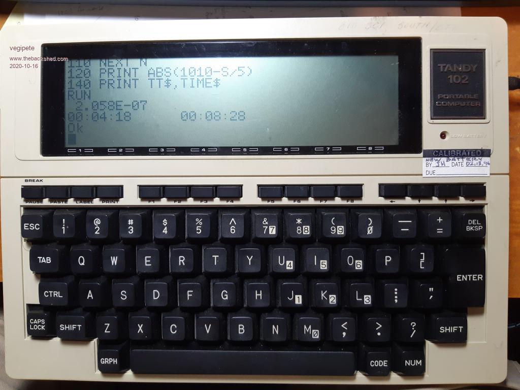

Speed, or lack thereof. 4 minutes and 10 seconds.
Perhaps of greater concern is the completely different answer than the CMM2.
