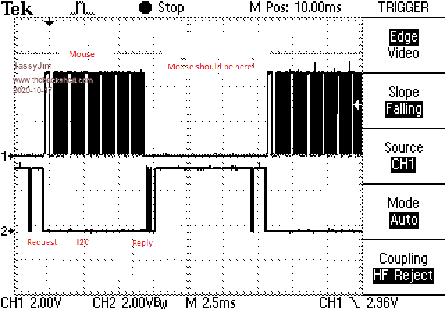

I have been playing with a Arduino nano HobbyTronics emulator for PS2 mice with limited success.
In theory, the software sends a copy of the most recent mouse data and then, once the data has been sent to the CMM2, it interrogates the PS2 mouse and prepares the next set of data.
That's the theory. In practice, the software insist on interrogating the PS2 mouse before sending it's reply to the CMM2. As the PS2 takes about 7mS to send it's data, there is an unacceptable delay in the I2C routines.
The I2C triggers every 16mS (same as nunchuk) and that means that half the time is spent waiting for the mouse. Not good!.
If anyone wants to fix my mess, please do.
Because of the timing problem, the mouse doesn't shut down cleanly every time which means that it can take a few starts to get it going next time.
So, not much use as is but hopefully a start on a simple PS2 to HobbyTronics mouse.

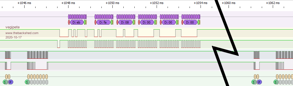

Interesting. Must be an Arduino thing. I'm not having any timing problems with a little PIC chip. That's within the nunchuk protocol, mind you.
My I2C routines are entirely interrupt driven. When the ISR has finished sending the I2C data, it sets a flag so the main routine can query the mouse. An entire mouse transaction takes about 6.5 milliseconds.
The CMM2 I2C nunchuk transaction takes about 2 milliseconds to send a payload of 6 bytes. The Hobbytronics payload is 10 bytes so hopefully it won't be much more. That should leave lots of time. I guess I'll know for sure tomorrow when I update the firmware.
There's something strange about your scope image. I would expect both mouse and I2C to idle high.
Mouse activity on the upper lines, I2C on the lower ones.

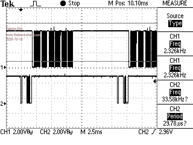

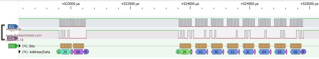

As expected, the Hobbytronics I2C read routine used by the new CONTROLLER MOUSE command works nicely. The overall transaction takes a smidgen over 2 milliseconds, and repeats every 16 ms.
The only nuisance I've seen are some occasional single glitches on SDA and/or SCL a few ms before the real show starts. Sometimes this fools my code so I may need to implement a timeout function...
Note, no real data in this yet, I'm still testing for robustness.

Some days nothing goes right.
Other days, the first search for information gives a hit and all your problems go away.
I found a site that explained the interrupts on the Arduino.
The PS/2 routines now happen in the correct sequence.
It is now working how I want it.
If you are using I2C for the link, there is no serial activity.
If the I2C is not used, serial updates happen every 35mS
Serial can be either the long winded HobbyTronics or a 4 byte compressed PS/2 format.
The HobbyTronics is human readable so handy for debugging.
I have had the occasional lockup with repeated stops and starts so I now need to put in a watchdog.
Having a PS/2 HobbyTronics emulator using a cheap Arduino is a nice option.

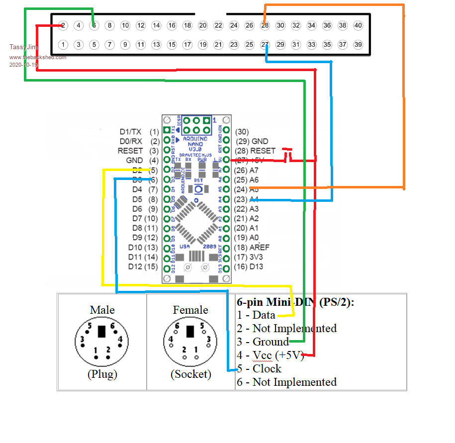

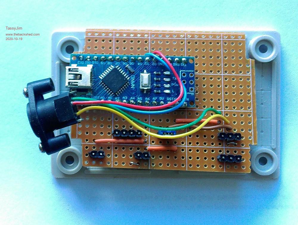

I used two resistors in the serial line to drop the voltage but you don't need to use it.
Any debugging can be done via the USB built in to the nano.
I will try and assemble my unit onto stripboard later today and do a circuit diagram.
I am still working out the 'soon to be added joystick' pins.

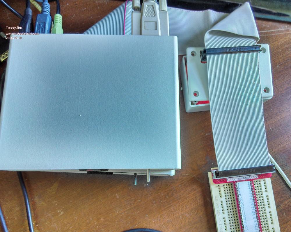

Posts: 6606
Posted: 06:30am 19 Oct 2020
I fitted a jumper in the 5V supply to the Arduino so that I can power the Arduino via the USB during programming and monitoring without having the two 5V supplies linked.
I chose I2C2 (pins 27 and 28) as that is the default for the CMM2 mouse.
I used a daisy chain IDE cable so that I can still have the breadboard attached.
I prefer this over an internal mouse house but that's a personal preference.
Fitting a joystick connector to the box is going to be tight but I have a big hammer so it will fit.

  TassyJim said
Missing a green wire (ground) from CMM2 to NANO (pin 29 or pin 4)
Edited 2020-10-20 03:25 by Volhout
Posts: 6606
Posted: 07:42pm 19 Oct 2020
Woops!
Thanks, it wouldn't go very well without that.
In real life I used both 5V and a few GND pins on the 40 way connector.
