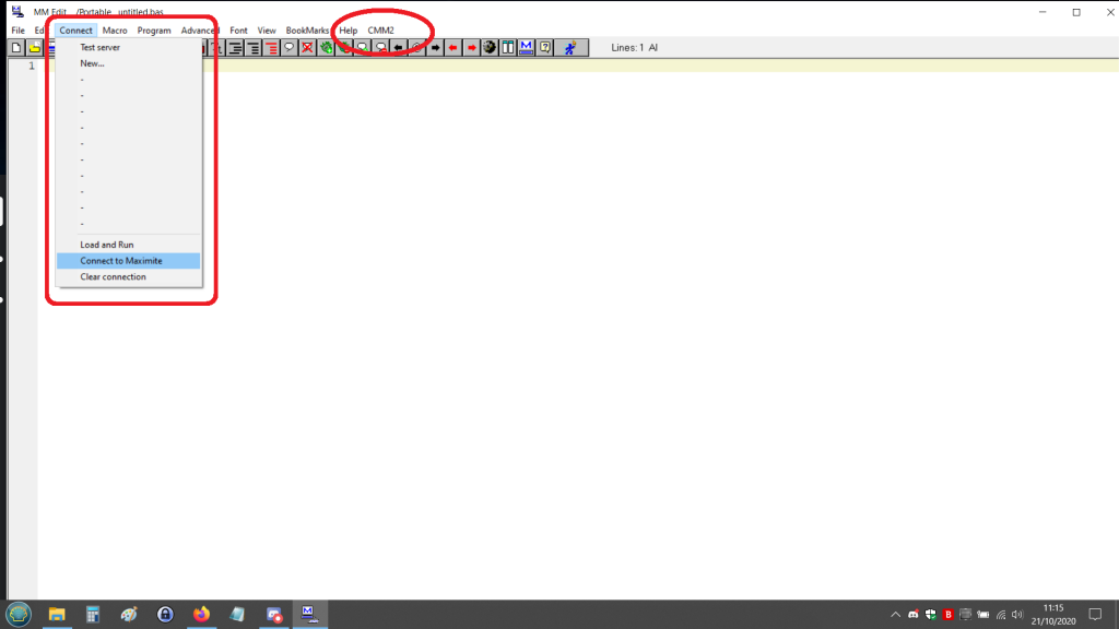

Hi ! If someone has a little time to help ?
Thanks in advance for your help. I know sometimes is might be hard to tell newbies the secrets but I want to learn and maybe get better in this ;-)
I have tried to connect the CMM2 to my pc and tried the MMEdit but I can't connect it to the computer somehow.
Can someone help me with the process how the setup will be correctly ?
As a beginner of this it's not easy to understand and I lack some knowledge how things work.
So lets start as if I just have bought this cool machine ;-)
I have a a-a usb calble and the cmm2 and the nice mmedit programm.
What should I do to use this correctly and can access my cmm2 from my pc with mmedit?

You need an A-B cable. The A connects to the PC, the B goes into the CMM2 instead of the power, the CMM2 will then get its power from, and can communicate with the PC.
Womble
Joined: 09/07/2020
Posts: 267
Posted: 10:27am 21 Oct 2020
@TweakerRay
CMM2 Manual v5.05.05 p15
The default settings for the serial over USB console are 115200 baud, 8 bits, no parity and one stop bit.
Personally I use TerraTerm, but the principle is the same for MMEdit.
You connect the CMM2 to your PC using the USB-A to USB-B cable (the one that normally powers the CMM2).
You do not need to connect anything to the USB-A keyboard port on the CMM2.
I have highlighted the settings you need to use to connect.  This is the Portable version 4.01 from here which does not need installing, just unzip and run MMEdit.exe
Hope that helps.

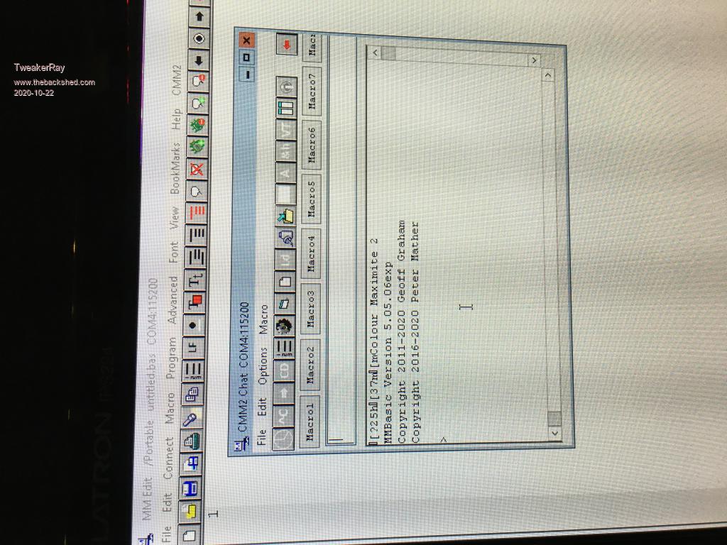

hmmm ... so I tried a different SD Card today ;-) a small one 256 mb only...
I could use the filebrowser but when I tried to upload a programm to the cmm2
it crashed again... the card was empty...
I made a test.bas and it stored a temp.bas on the card but the filebrowser on the pc then crashed again...
I deleted (actually just put them in another folder outside that directory) you said:
locate.inf, macro.inf  >>> where moved out of that folder
Now I could use the filebrowser, upload a short test.bas and it saved correctly.
I tried the small icon "Load and run current code" but it gave me an
error after it said
Load"temp.bas"
syntex...
Hmmm... what do I do wrong ?
I checked the files on the MM2
The temp.bas and Test.bas i transfered before where there but they had a
long ZZZZZZZZZZZZZZZZZZZZZZZZZZZZZZZZZZZZZZZZZZZZZ Line at the end...
My programm only was
10 Print"Hello World"
20 goto 10
and it added below that in inverse writing
ZZZZZZZZZZZZZZZZZZZZZZZZZZZZZZZZZZZZZZZZZZZZZZZZZZZZZZZZZZZZZZZZZZZZZZZZZZZZZZZZZZZ
so maybe the CMM2 was sleepy or my code was too boring ;-)

XMODEM always pads the last packet out to 128 bytes using either chr$(0) or chr$(26)
That's the way it's always been and there is no easy way to remove the trailing characters.
Try opening the chat window and using the "LOAD" button.
That method uses AUTOSAVE instead of XMODEM  and doesn't add the padding characters.
It will still save your code as temp.bas but in the next release of MMEdit, you will have the option of saving under the current file name instead of temp.bas
