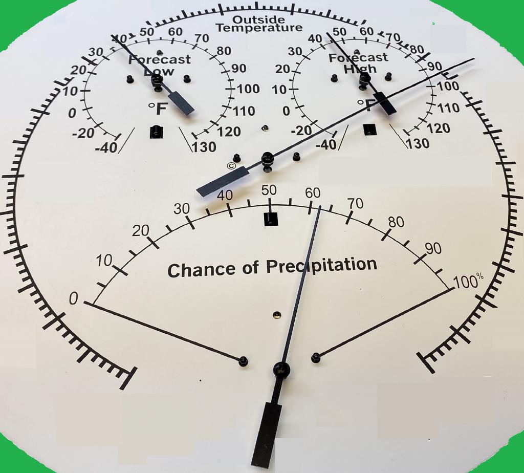

The end result will be a dial about 11 inches diameter, appx 280mm with the main dial showing outdoor temp at the moment and other dials showing indoor temp, min/max temp and chance of precipitation and connect to my weather station to easily see the weather at a distance
I'll probably have a dual shaft one with min and max temp as one of the dials, main dial will be outside temp, also one showing indoor temp

The motors I chose are from a car dashboard and have limit stops that limits shaft rotation to 315 degrees
I don't need 360° for this application so they are ideal

I've been trying to find needles for the motors but I can't find any suppliers at all
The only thing I can find is clock hands which isn't what I want
Anyone know what they are actually called?
if I search for needles it comes up with sewing needles, gauge needles and it comes up with car gauge needles which are way too small
something like the needles on this

Maybe buy 3 sets of these, and only use the seconds hand
hands
