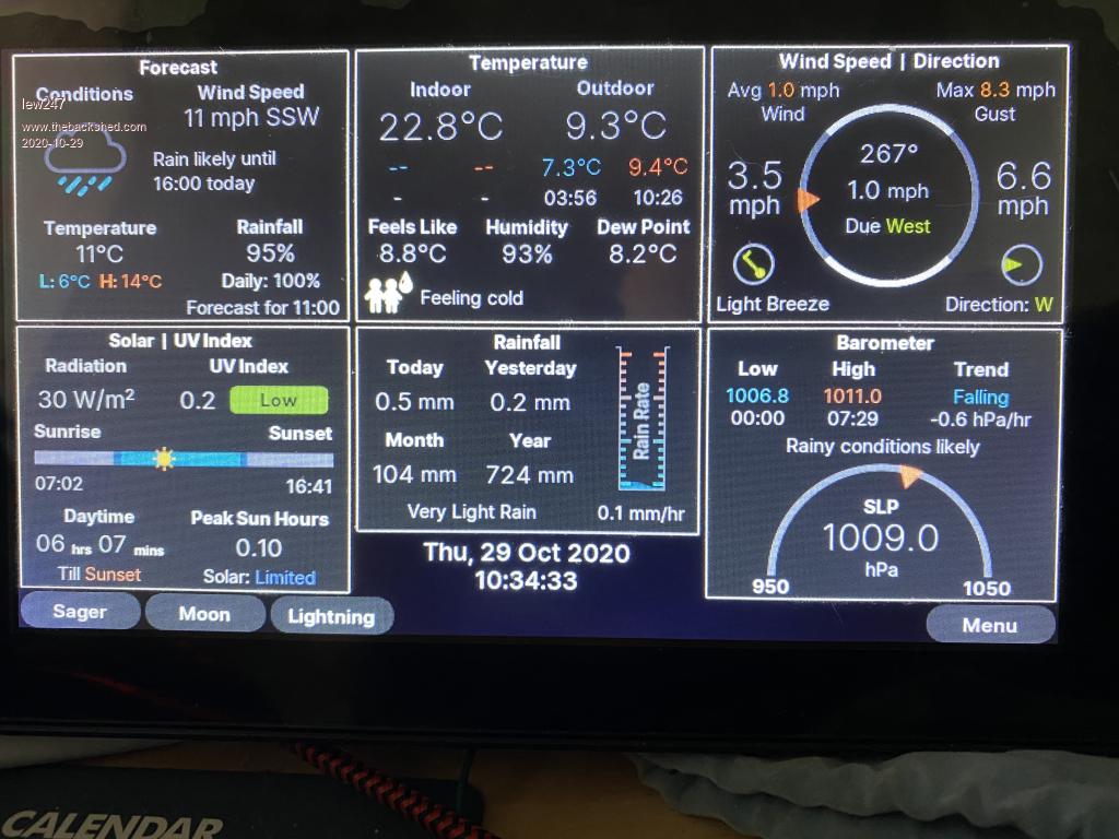

I'm trying to get my Si7021 temp/humidity module working with Python
I've got it working great BUT
I cannot fathom or figure out how to get the min and max temperatures to check if the date has changed then use the current values
date has changed means its a new day ie just gone midnight
This is the code thats working perfectly

This is what I'm trying but it keeps coming up with errors

  # Define maximum and minimum temperature and time
  MaxTemp = Temp,'c',datetime.now()
  MinTemp = Temp,'c',datetime.now()
#This is what I am trying to modify to work
MaxTemp = [max(Temp)[0],'c',datetime.fromtimestamp(Time[Temp.index(max(Temp))][0],Tz).strftime(Format),max(Temp)[0],Now]
MinTemp = [min(Temp)[0],'c',datetime.fromtimestamp(Time[Temp.index(min(Temp))][0],Tz).strftime(Format),min(Temp)[0],Now]
  # Else if midnight has passed, reset maximum and minimum temperature
  if datetime.now() > MaxTemp.date
       MaxTemp =Temp
       MinTemp = Temp
   # Else if current temperature is greater than maximum recorded temperature,
   # update maximum temperature
  elif Temp > MaxTemp:
       MaxTemp = Temp
       MinTemp = MinTemp
   # Else if current temperature is less than minimum recorded temperature,
   # update minimum temperature
  elif Temp < minTemp:
       MinTemp = Temp
       MaxTemp = MaxTemp
   # Else maximum and minimum temperature unchanged, return existing values
  else:
       MaxTemp = maxTemp
       MinTemp = MinTemp
   # Return required variables
  return MaxTemp,MinTemp
  # Get new temperature in 60 seconds
  Clock.schedule_once(partial(read,Obs), 60)
  # Output data to screen *** this is what I need sent to the Display***
  #print ("Humidity %%RH: %.2f%%" %humid)
  #print "Temperature : %.2f C" %cTemp
The error at the moment is
  Quote     File "/home/pi/wfpiconsole/lib/SI7021.py", line 46
SyntaxError: invalid syntax
Anyone know a simpler way to get the min and max temps and change them to zero at midnight?
The two variables I need are
MinTemp
MaxTemp
and update at midnight (new date)

  Quote  File "/home/pi/wfpiconsole/lib/SI7021.py", line 44
    if datetime.now() > MaxTemp.date;
Edited 2020-10-29 04:25 by lew247
lew247
Joined: 23/12/2015
Posts: 1702
Posted: 06:26pm 28 Oct 2020
I used a semicolon to get the above error
When I use a colon
I get
  Quote  2020-10-28 18:26:07+0000 [-]   File "/home/pi/wfpiconsole/lib/SI7021.py", line 44, in read
2020-10-28 18:26:07+0000 [-]     if datetime.now() > MaxTemp.date:
2020-10-28 18:26:07+0000 [-] AttributeError: 'tuple' object has no attribute 'date'

I'm getting a bit further

I've got as far as line 58 now
  Quote  2020-10-28 19:23:06+0000 [-]   File "/home/pi/wfpiconsole/lib/SI7021.py", line 58, in read
2020-10-28 19:23:06+0000 [-]     if Temp < MinTemp:
2020-10-28 19:23:06+0000 [-] TypeError: '<' not supported between instances of 'list' and 'tuple'
Edited 2020-10-29 05:24 by lew247

If I delete the section in red it all works
if I put it back in I get the error:
  Quote  2020-10-28 19:50:49+0000 [-]   File "/home/pi/wfpiconsole/lib/SI7021.py", line 58, in read

lew247
Joined: 23/12/2015
Posts: 1702
Posted: 10:12am 29 Oct 2020
To achieve what I need is beyond me I'm afraid
I needed to accomplish this
  Quote  In the SI7021.py file the variables you need to set are Obs['inTempMin'] and Obs['inTempMax']. The format of these variables needs to be a list, with five elements in each. The elements are
max/min temperature as a string,
u'\N{DEGREE CELSIUS}',
time of max/min formatted as a string,
max/min temp as a float,
time of max/min temp as a datetime
I got lost at string float and datetime in Python
Given up for now, I'll stick with the the temperature now showing on the display
Edited 2020-10-29 20:39 by lew247
