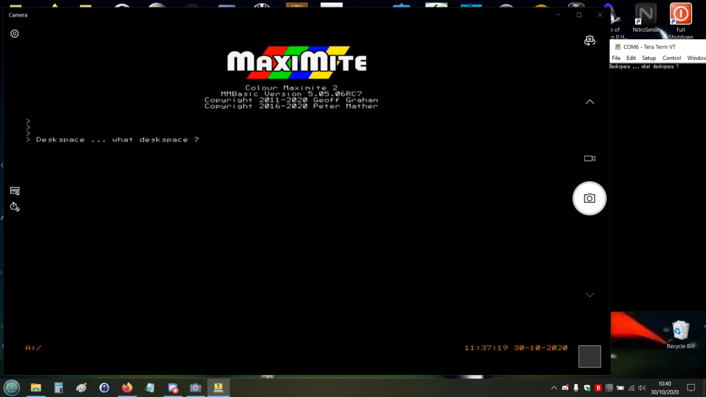

This link and others on the forum discusses VGA-->HDMI connection for the CMM2.
The problem is similar for VGA-->DiplayPort.  You need to convert an Analogue signal into a Digital one.  A passive cable wont do the job.  Depending on the Display Port specification you MAY be able to convert an HDMI signal into Display Port with a passive cable but YMMV.  And you will still need a converter box.
Probably cheaper to get a cheap monitor or TV with a VGA input ... Goodwill/Ebay ???
I bought a brand new in box IIyama 19" lcd monitor for around £25 delivered over here just by scouring UK Ebay.
If you are short of deskspace and want to use your existing monitor I  can recommend this VGA-->USB capture device to connect to your PC.  The CMM2 can then be displayed in a window using software like Windows Camera, and the CMM2 connected to using an extra keyboard, or the serial console and TerraTerm or MMEdit.  I use this setup to program my CMM2 on my laptop in the living room.
AliExpress link

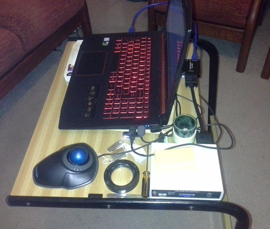

Desktop Space ... What is this Desktop Space of which you speak ?
This is my "Living Room" setup.
I have a second CMM2 setup in the workshop with a monitor and keyboard, but for coding in front of the telly I use the VGA Capture device to display the screen on my laptop, and enter text using TerraTerm via the laptop keyboard.  Very Compact.
My eyesight survives unless I code too much

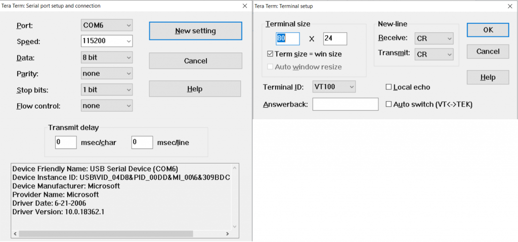

  Krall said  I couldn’t quite get serial terminal to work right on the CMM 1 so I’m hoping on the 2 that just arrived (thanks Circuit Gizmos!) fairs better. I still like your video capture idea best. That would make everything remote and I’d still be able to use video.
Here are the TerraTerm settings I use.  The serial connection passes over the USB A-B cable which I am using to power my CMM2 from the laptop.
Video obviously goes via the VGA Capture Device (blue cable in my photo)
And yes, that Laptop keyboard is hideous

Thanks for the settings, I'll try it. I had to order a microSD card as my RetroMax uses that which I didn't know. I also ordered the video capture device.
EDIT: Genius Womble! Those TeraTerm settings got me right in! I was using other settings from the board that I found which did not work :)

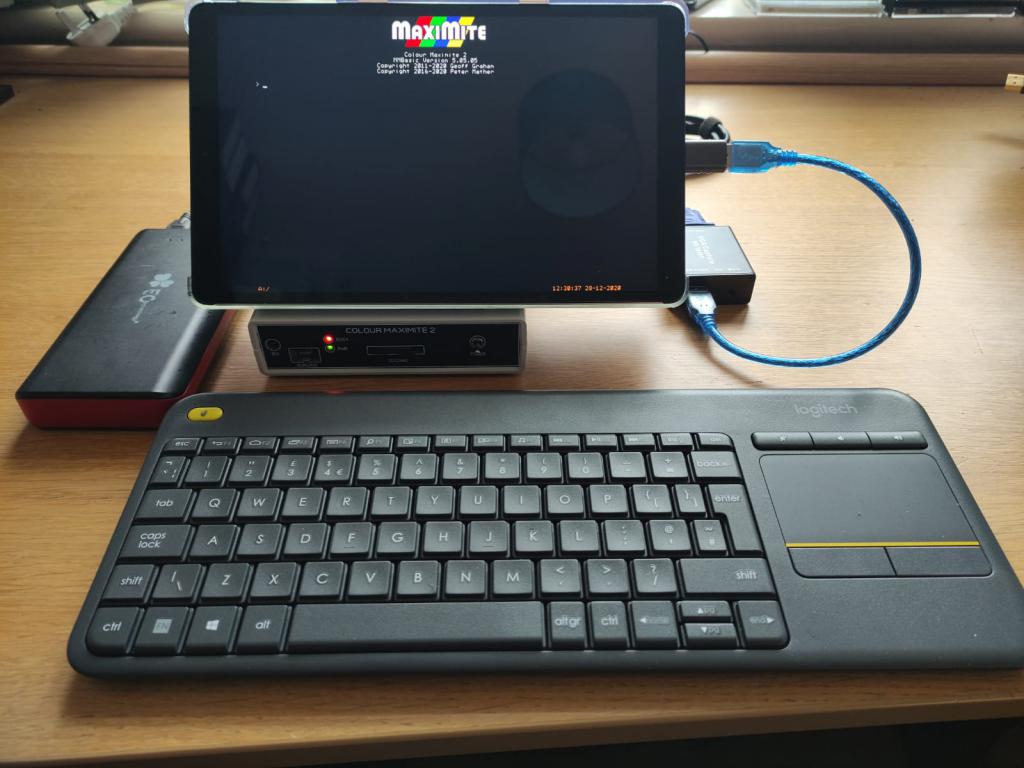

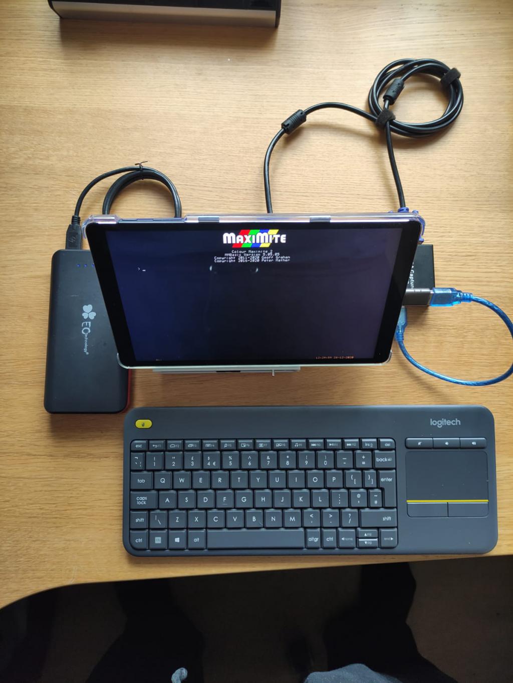

For those looking for a "portable CMM2", this could be interesting.
(The blurring is my dodgy photo taking, not the signal to the tablet)
I used the USB Camera app from the Play Store.  I upgraded to the Pro version £5, but the free version works pretty well providing you don't mind adverts.
I had to change my screen settings on the tablet.  I'm still experimeneting, but YUV2 800x600 @ 20FPS seems good for basic editing)
Original inspiration from ETA Prime
