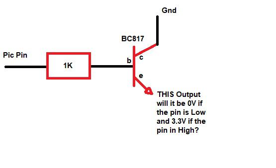

I need an output from a Pic pin to switch the shutdown on a buck converter that converts 3.3 to 5V
If the Shutdown pin on the  buck converter is below 0.4V the buck converter is switched off
if the pin is high the converter switches on
I'm making a circuit that needs 3.3V from the pic easy enough but it also needs 5V for a different ic and it's being powered from batteries so the current draw needs to be as low as possible, ie the converter only turned on when needed
Should this circuit work? it's only to switch the Shutdown pin on THIS module

I don't think so. You need a converter configuration with a pull-up resistor.
If the PIC has a 5 volt compliant pin a direct connection should be OK.

Well, No!
The data sheet specifies that the power converter module has a 100K pull-up resistor on the shutdown input.
Assuming that your Pic is running at 3.3V, you will need the collector of the NPN transistor tied to +3.3V and move the 1K resistor to connect the emitter to ground.  then your shutdown signal would be connected at the junction of the emitter and resistor as in your diagram.

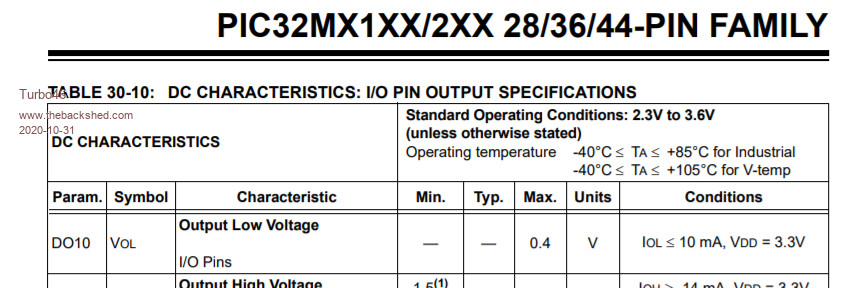

I would be very surprised if a PIC output could not reliably pull 100k down to below 0.4v.

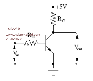

This is the circuit I meant.
Use 100k for RB and you can omit RC if the inverter has a pullup resistor on board. If not a 100k resistor would do. Any small signal NPN transistor will do the job.
An active pull down for a logic 0 is far better than using a resistor divider.
But a straight connection to a 5v compliant pin is just so simple.
Bill
twofingers
Joined: 02/06/2014
Posts: 1761
Posted: 11:33pm 30 Oct 2020
  Turbo46 said  I would be very surprised if a PIC output could not reliably pull 100k down to below 0.4v.
Sorry, I would expect 0.6-07V. Or?
Michael
Turbo46
Joined: 24/12/2017
Posts: 1693
Posted: 11:47pm 30 Oct 2020
From a datasheet:
That's for 10mA not a few uA.
Bill

Turbo46
Joined: 24/12/2017
Posts: 1693
Posted: 01:49am 31 Oct 2020
Thank you Michael.
  Quote  But is it clear that the circuit inverses the voltage?
I perhaps should have made that clear. I did mean to type inverter and not converter on my first post.
But hopefully a direct connection to a 5v compliant pin is all that is required.
Bill
@Hitsware2, That circuit could work but it relies on the transistor being open circuit when the input is low and R2 pulling the input to the buck converter low. But when the input is high the base current drawn from the PIC would be high and the voltage at the base of the transistor would only be approximately 2.8 volts (3.3v-0.7v) maybe not enough to enable the buck converter. Thank you for the interesting site.

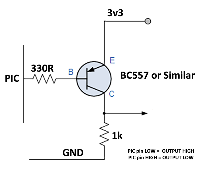

Posts: 2981
Posted: 03:11am 31 Oct 2020
Hi Lew, All,
You might not get the output low enough using an NPN transistor, if not try a PNP transistor as per this cct
It was mentioned that there is a 100k pullup on the buck convertor so the 1k on output should pull that pin LOW when the PIC output pin is HIGH.
When the PIC pin is LOW the 3v3 volts (HIGH) should get switched through to the output.
If you need the buck convertor ON or OFF when the PIC is not powered you might need a pull up or pull down at the PIC pin

lew247
Joined: 23/12/2015
Posts: 1709
Posted: 09:36am 31 Oct 2020
Apologies
I completely messed up in the first post
It should have said Micromite pin (actually Armite), not pic
I'd been looking at numerous microprocessors during the day and my mind went to mush
I'm wondering if I could drive that pin low by directly connecting it to the Armite pin (with a capacitor across it)
