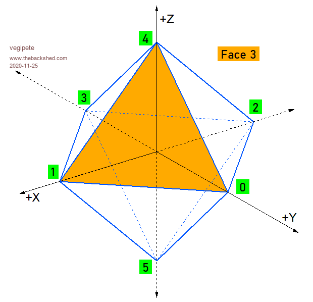

  matherp said  and finally the calculated surface normals for each face based on the 1st point-2nd and 3rd-2nd.
It is this latter that I really need to be sure of before I go any further.

Face 3 vertices , 0, 4, 1,   83.3333,   83.3333,   83.3333,   -0.5774,   -0.5774,   -0.5774
Excellent start. However, the face normal looks mathematically backwards if positive is to be outward.
Something needs to flip. Could be (1st point - 2nd point) and (1st point - 3rd point)
Or (1st - 2nd), (2nd - 3rd)

Think it is correct. The greater the Z the further away. Face 3 has positive Z therefore -ve normal so don't display

For the given coordinates, face 3 has vertices at:
(0,250,0)  (250,0,0)  (0,0,250)
Centroid at (83.33, 83.33, 83.33) seems correct.
The outward normal should be (positive,positive,positive), which is pointing away from the origin.
The face normal is unrelated to the viewer. The angle between the viewing direction and the face normal determines visibility, but your initial data makes no reference to viewing position/direction.
This image is orthogonal projection, not perspective. I'm quite sure I have my axis orientation correct for normal right handed geometry. The translation to flipped screen coordinates (since positive y is down on the screen) must be done with care.

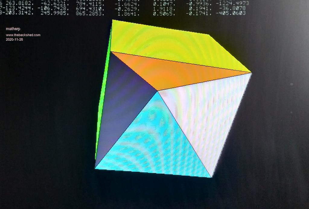

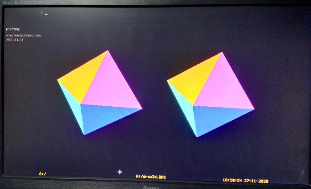

I'm making progress with the 3D engine. The code for defining a 3d object is all up and working as is a basic display mechanism.  I'm going to be doing all the rotation using quaternions and have implemented a new MATH sub-command
MATH Q_EULER yaw, pitch, roll, q(). This is in the latest beta (b6) and converts the angles (Radians but you can use OPTION ANGLE) into a rotation quaternion.
With the camera facing the object yaw is looking from the top of the object and rotates clockwise, pitch rotates the top away from the camera and roll rotates around the z-axis clockwise. Have a play if you have time.
Now the question for my 3D guru team:
Up until now we have assumed the camera is looking along the z-axis and the viewplane is at constant z. However, I want to be able to define the yaw angle and pitch angle of the camera away from the z-axis (roll probably a step too far in processing terms). In both cases it means the viewplane needs to be orthogonal to the camera angle so is no longer orthogonal to z
Can anyone point me at the math needed to do the projection from the object to the 2D representation on this tilted viewplane?

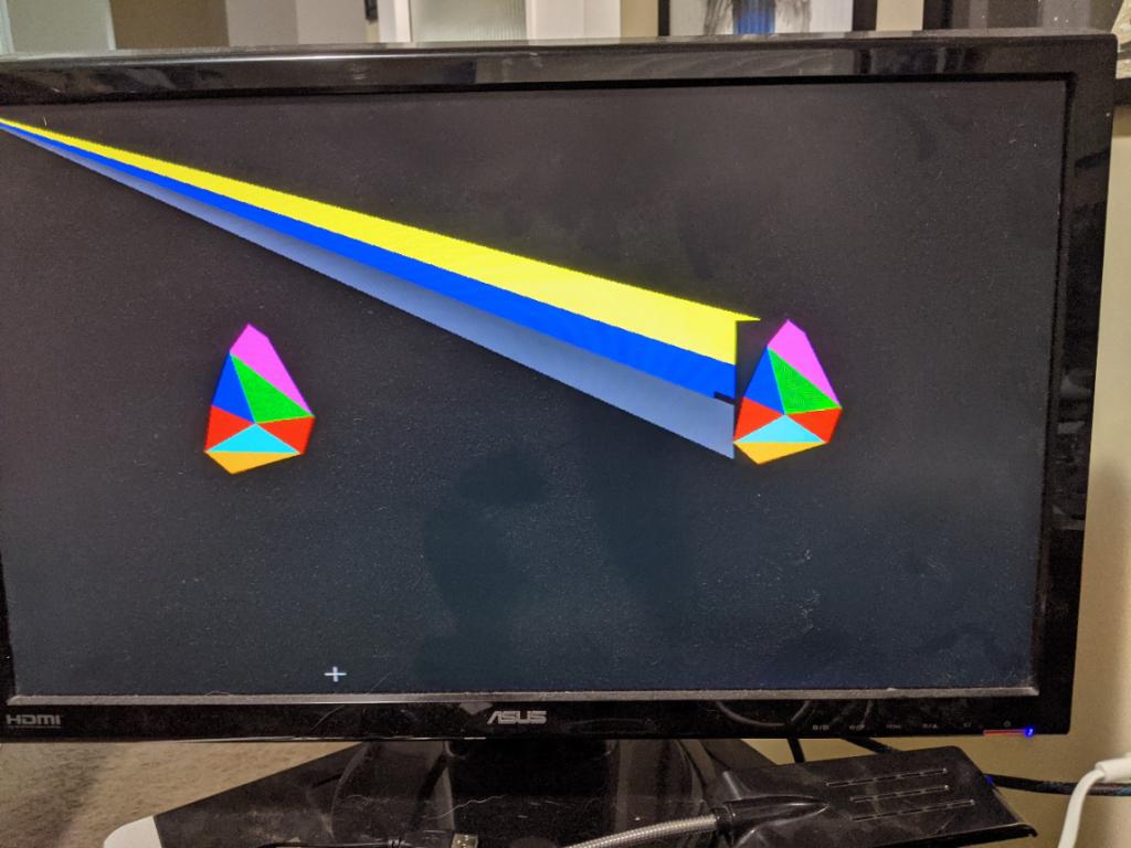

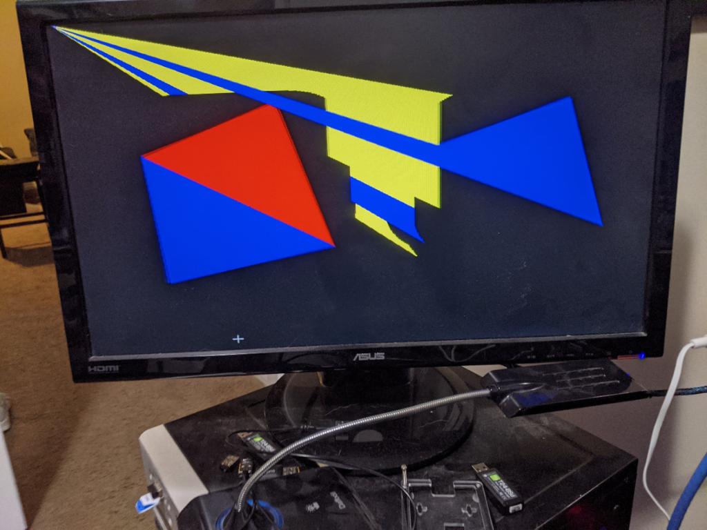

The roll/pitch/yaw step gets applied at the projection stage and is simple enough. Indeed, I was looking at rotating the octahedron this way early on.
Here is an earlier version of my code. (Face drawing was not working right at this point, as you'll see when you run it.) On the left is the view of a fixed wireframe octahedron as the viewer moves around it. The magic math can be seen on lines 83 to 87 and the subroutine 'project'. If you compare the subroutines 'project' and 'project2', you can see the difference between the viewer fixed on the z-axis and the viewer moving around. For the fixed viewer, the view angles are theta=90 and phi=0. Phi is the angle from the +Z axis, theta from the +X axis, counter-clockwise positive.
Note: when you are sitting on the z-axis, a theta rotation looks the same as roll. 'Gimbal lock', I think. Change line 84 to "phi = 0" to see this.
Roll could be handled the same way at the same time, by taking the (x,y) of a given projected vertex and performing a simple point rotate. The slight gotcha is the relative direction: if the viewer rolls counter-clockwise, the view rolls clockwise.
xn = x*cos(roll angle) - y*sin(roll angle)
yn = x*sin(roll angle) + y*cos(roll angle)

Guys
It would be great if you could find time to have a play with the attached hack version
CMM2V1.5.zip
This has the start of the 3D engine. The four commands implemented so far should be obvious from the example program
option explicit
option default float
dim integer camera_y = mm.vres-20
dim integer viewplane = 700
dim integer camera_z = 0
dim integer camera_x
dim integer c
timer=0
dim q(4)
dim yaw=rad(1),pitch=rad(2),roll=rad(0.5)
dim integer nv=6, nf=8 ' octahedron has 6 vertices and 8 faces
'array to hold vertices
dim v(2,nv-1)=(0,250,0,   250,0,0,   -250,0,0,  0,-250,0,   0,0,250,   0,0,-250)
' array to hold number of vertices for each face
dim integer fc(nf-1) =(3, 3, 3, 3, 3, 3, 3, 3)
dim integer bcol(nf-1)=(rgb(red),rgb(blue),rgb(green),rgb(magenta),rgb(yellow),rgb(cyan),rgb(brown),rgb(gray))
dim integer fcol(nf-1)=(0,0,0,0,0,0,0,0)
'array to hold vertices for each face
dim integer fv(math(sum fc())-1)=(0,5,2,  0,1,5,  0,2,4,  0,4,1,  3,2,5,  3,5,1,  3,1,4,   3,4,2 )
gui cursor on 1,40,camera_y
' create 3D object number 1
draw3d create 1, nv, nf, v(), fc(), fv(),bcol(),bcol()
' create 3D object number 2
draw3d create 2, nv, nf, v(), fc(), fv(),bcol(),bcol()
page write 1
for c=0 to 720
 camera_x=c+40
 draw3d camera 1,viewplane,camera_x,camera_y,camera_z
 draw3d camera 2,viewplane,camera_x,camera_y,camera_z
 draw3d show 1,mm.hres\4,mm.vres\2,1000
 draw3d show 2,mm.hres\4*3,mm.vres\2,1000
 math q_euler yaw,pitch,roll,q()
 draw3d rotate 1,q()
 draw3d rotate 2,q()
 inc yaw,rad(1)
 inc pitch,rad(2)
 inc roll,rad(0.5)
 gui cursor camera_x,camera_y
 page copy 1 to 0,b
 do while inkey$="":loop
next
print timer
draw3d close all
It easily wins the challenge when configured appropriately but in the example I single step by pressing any key.
Each iteration rotates the two octahedron and also moves the camera position.
At the moment the SHOW command just clears the minimum area where the object was previously displayed.
The bit I'm not confident in is the 2D rendering dependent on camera position but it seems to do the right sort of thing.
The tricky bit was getting the face ordering. The firmware sorts the faces by the dot product of the normal vector and the ray and that seems to give the correct order. Otherwise with different camera positions there are faces that are correctly not hidden but shouldn't show.
Note that there is a camera position associated with with each object so that different views can be shown simultaneously but currently the same object can't be shown in different places, although, as in the example the same meta-data can easily be used for multiple objects.
Object rotation is deliberately separated from showing the object so that you can move the object round the screen separately from changing its orientation
