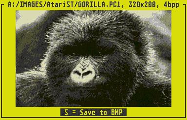

Hi Jiri,
I'm having trouble with the Graphics Viewer. I down-loaded the images you used above (from ffmpeg/atariST.org) and then tried the Viewer on them. Both seemed to load OK but when the progress bar came to the end it threw an Error:
"Error in line 3748: Argument list."
Greg

Hi Greg,
it looks like older version of GRF.INC. What version you have (it's all either in new NC under F10 or in files on begin as VERSION.NC for NC.BAS, VERSION.GRF for GRF.INC and VERSION.TUI for TUI.INC)?
If the error line is with
GRF.loadST(filePath, 0, 0, 1, 1)
in older GRF.INC was not used the 4th parameter (progress bar ON)...
Newest versions are:
NC 1.13
TUI 0.40
GRF 0.10
Edited 2021-02-01 19:59 by jirsoft
Jiri

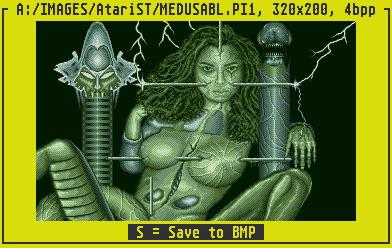

Hi Greg,
I was not able to reproduce the error, can you attach here the file (picture) you used? Anyway I found other bug in palette calculation, so I re-uploaded all the files to the GitHub again, please try to use newest version...
And after fix, the ST pictures should look so:
Jiri

Posted: 02:13am 02 Feb 2021
Hi Jiri,
Downloaded from Github again, TUI and GRF both V0.14 - but NC also shown as V0.14, I assume that should be NC V1.14.
Tried again but a problem still there - on my setup anyway. Tried to view GORILLA.PC1 but this time it didn't get as far as the progress bar. As soon as I pressed F3 key it threw an error:
Error in line 3740: GRF.GETSTINFO is not declared.
Some more info in case it's relevant: I'm running Peter's latest b11, and for some reason it's not clearing memory when I power off the CMM2. When I power on again it reboots straight into the previous program, which at the moment is NC. It's behaving like AUTORUN is ON.
More info: I downloaded the AtariST graphics files from: Sample AtariST. Also my NC.CFG file shows 1000.

Posted: 01:42am 03 Feb 2021
Hi Jiri,
I finally found my dumb mistake. I hadn't checked whether the #INCLUDES were uncommented in the NC code like they were in the SimpleEd code. I'd been using NC before SimpleEd and didn't go back - Duhhh....
The VIEWER's working great now, congratulations!
I also tried the .BMP save from the viewer and that works well. Also the SCREENSHOT for 'whole of screen' and 'current view' and they both work nicely - well done again!
I haven't got PYTHON loaded on my system so can't check the serial server capabilities yet. I'll give that a go sometime soon and also set up an 8266 link (hopefully) using Peter's recent info.

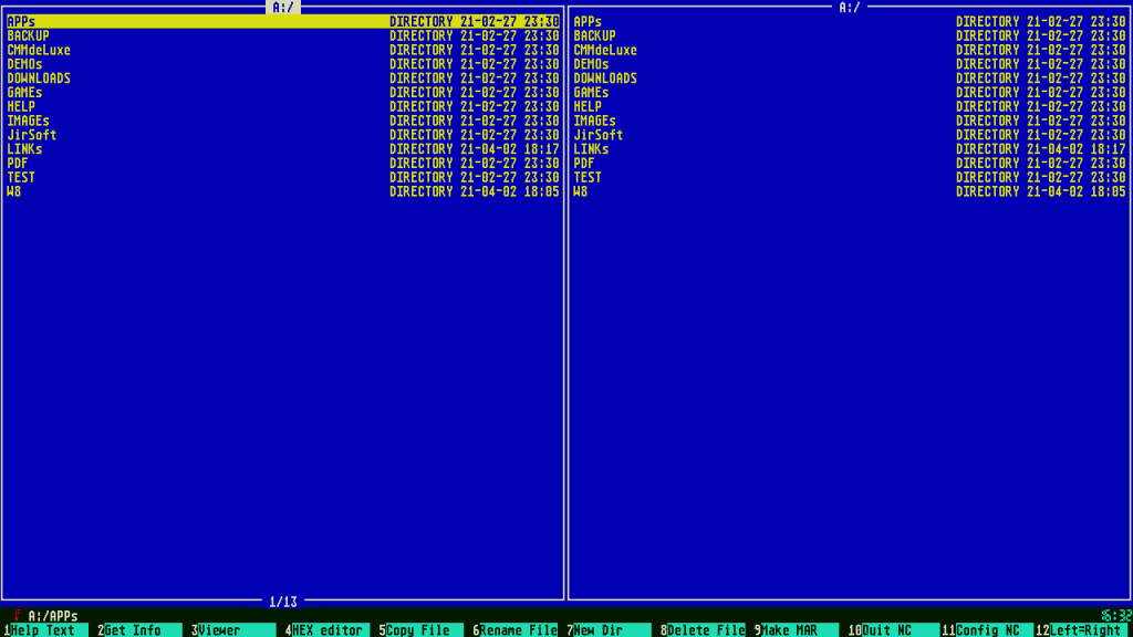

Hi Jiri,
I'm reorganizing a directory structure on my CMM2, and I'm happily using NC to do this.
I have one very minor suggestion for you to consider: Whenever I move (Alt-F5) a file from one tab to another, the cursor gets reset to the top of the directory and I have to find again where I was in my (way too long) directory. To me, it would make sense if the cursor just goes to the next file in the list, i.e. the one after the file that's being moved.
Just a thought. Thanks again for this great tool.
Ruben/Epsilon.

Hi Ruben,
I'm right now in the process of bigger upgrade of NC (mainly network part, but also some minor things), and this I have in roadmap for longer time (but I was too lazy). You are right, it needs to be finally done
Jiri

Posted: 05:30pm 03 Apr 2021
Hi,
so finally again some progress in Napoleon Commander  (v1.24):
+ some operations are faster
+ improved network speed and reliability with new server (50-60kB/s transfer speed in both directions)
NCwifiServer.py 0.26 and ESP8266 OTA firmware (0.65) - both needed to be updated as well
+ on many operations cursor is not jumping to first file/dir anymore (Ruben   )
+ preparation for FTP server and ELF to CSUB convertor
- serial transfer not tested (so maybe not working), I need to retest it and possibly update NCserialServer.py
Enjoy (and give positive or negative response, please)...
Jiri

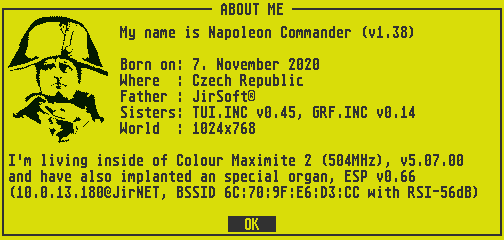

Hi,
new version of Napoleon Commander (v1.26) is here:
+ improved transfer speeds over both serial and WiFi, tested on CMM2 Deluxe by Piotr
new ESP8266 firmware v0.66 needed, can be installed over-the-air (OTA)
and also NCserver.py v0.28
+ new python server combine serial and WiFi server:
python3 NCserver.py -h
Napoleon server v0.28
NCserver.py -s <serverdir> -i <CMM2 IP> -v <verbose level>
NCserver.py -s <serverdir> -p <port> -v <verbose level>

Hi all,
I have just put on the GitHub new NC v1.33. What's new:
(mostly) resolution independent, you need just to have at least 800 pixels horizontal, partially is also menu extended with bigger resolution (4 steps)
if somebody use it with CMM2 G2 and 1920x1080, please let me know if it works...
new configuration system (old file will be converted)
bugfixes (mainlyly error trapping)
speed up in file sorting
So enjoy!
