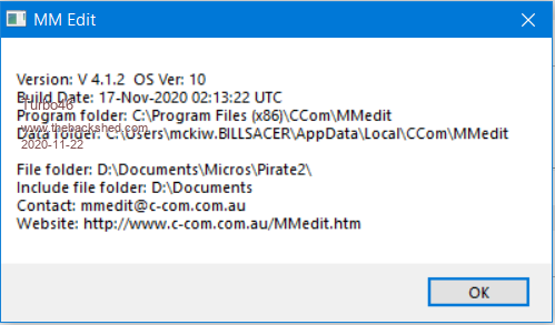

I'm using MMEdit with DOS MMBasic and it seems to be saving to a temp.bas file only and not to the original file. The original file is untouched from yesterday.
I am using the latest version (I think).
Bill
Edit: If I load the temp.bas file and run it, the temp file is updated when this happens.
BUT if if I run the original (old) version then the temp.bas file is overwritten and the earlier version is lost. I was confused because work I had done last night seemed lost but I realized too late that it was there in the temp.bas file.
BEWARE BEWARE
2ND Edit: It's not actually saving the original at all when you click on the 'save' button. Only the temp.bas file when it is run. You can 'save as' the same file name and it will overwrite and save the orignal though.
Edited 2020-11-22 12:42 by Turbo46
Posts: 6538
Posted: 02:38am 22 Nov 2020
MMEdit has always created 'temp.bas' to 'run in Dos'.
There was a brief period when MMEdit was not saving correctly. It tried to save without the full path specified so Windows did what it thought best.
That version was only up for a short period but it sounds like you may have it.
Check the build date in 'About' or the configuration report. The date and time,not just the version.
It should be:
  Quote  MM Edit Version: V 4.1.2  20201119065223
Build Date: 19-Nov-2020 06:52:23 UTC
If that's not the problem, I need a copy of your configuration report to look further.

Posted: 02:48am 22 Nov 2020
Thanks, I'll download and try again.
Bill
Turbo46
Joined: 24/12/2017
Posts: 1693
Posted: 02:55am 22 Nov 2020
All fixed! Thanks Jim.
Bill
