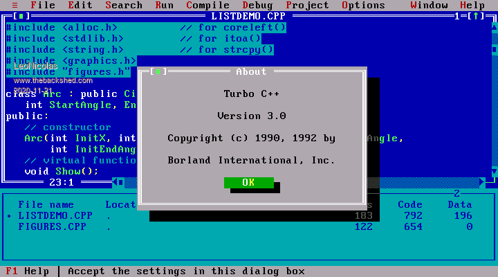

  matherp said  Jim
I've been waiting for just this sort of list. Are you OK for me to build it into the firmware as a help command?
This will be amazing. It will be like the old Borland Turbo C with its super handy hrlp

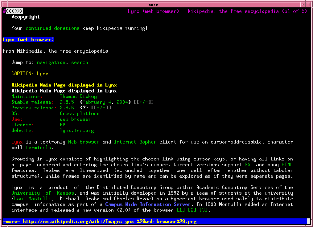

The Lynx display would be a good starting point for a look and feel for a help system:
I think that it would be a huge task to implement an HTML browser in the CMM2 firmware and there would be nothing but bug reports ad nauseum. Peter doesn't need that headache.
But a help facility in EDIT would be grand. If it can read external files (from A:/help) then users can contribute to this help system.
If a simple mark-up language can be used to provide the ability to change text color, provide links (from one help file to another), and even a link to an image that can pop up in a window using the recent additions Peter made to the language, this would go a long way toward the appeal of this system to the education market.
