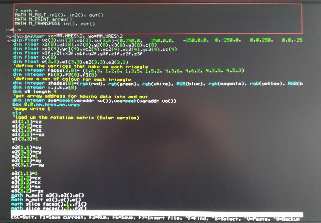

V5.06.00b3
The version fixes a bug in drawing commands when an expression for one of the parameters is > 32 characters
In addition it includes a limited help capability
HELP [text]
e.g. HELP DO
This displays up to 3 lines of help that match the "text". text isn't quoted.
If text isn't specified you can type characters into the help command and the display will show up to three lines than match
You can use up arrow and down arrow  to move through matches (e.g. for things like MM.INFO)
Exit the help command with either ESC or F12
In addition the command can be called from within the editor using F12. In this case the HELP command is called with any characters under the cursor up to the next character that can't form part of a command or function name. So if the cursor is positioned on the 'D' of a DIM command the help will immediately show the syntax for DIM
The text in the help facility is that supplied by TassyJim (many thanks) but I will accept sensible improvements within the limit of one line per entry (Max 100 characters in MODE 1)
The intention of the facility is just to provide a quick check on command syntax and will never replace the written manual. In the picture I pressed F12 on the MATH command and then added the ' m' in the help dialogue to filter the many 'MATH' results

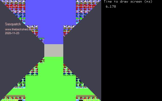

Here is a screen-shot of vegipete's 3D Maze demo.  As you can see, there are artifacts from the prevously run program (Gauntlet).  This seems different than before? V5.06.00b3
Adding a CLS before loading the graphics to Page 2 fixes the problem.  I suppose it's a philosophical question about which Pages should be cleared when a program is run or a NEW command issued?

vegipete
Joined: 29/01/2013
Posts: 1185
Posted: 12:08am 23 Nov 2020
I thought I fixed that screen corruption long ago. Perhaps the fix is in my new version, with chests and ladders ... which I haven't released.
  Sasquatch said  I suppose it's a philosophical question about which Pages should be cleared when a program is run or a NEW command issued?
No philosophy required. The programmer is responsible for initializing all data structures. Period. I didn't in my 3D maze program. Bad me.
Just like the programmer is responsible for sanitizing all input and handling buffer under and overflow properly.

  Quote  As you can see, there are artifacts from the previously run program (Gauntlet).  This seems different than before? V5.06.00b3
Only page 0 is cleared with a RUN same as before but the memory layout is different so you are seeing a different bit of uncleared memory - will look at clearing all video memory when RUN
