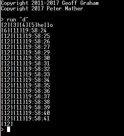

I changed the time to 5 seconds
it just loops between lines 11 and 12
TRACE ON
SetTick 1000, UpDateTime, 1
Print "hello"
Pause 5000 ' 5 seconds
End
Sub UpDateTime
Print time$
End Sub
If I don't use SETTICK then it works perfectly

Posts: 6606
Posted: 08:05pm 05 Dec 2020
OK
It looks like the Pi PAUSE hides the interrupts.
Instead of PAUSE 10000
try
for n = 1 to 100
PAUSE 100
next n
That will allow the one second ticks to fire.
