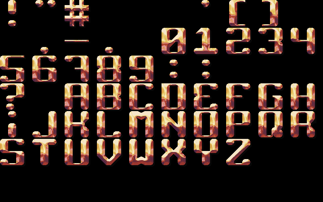

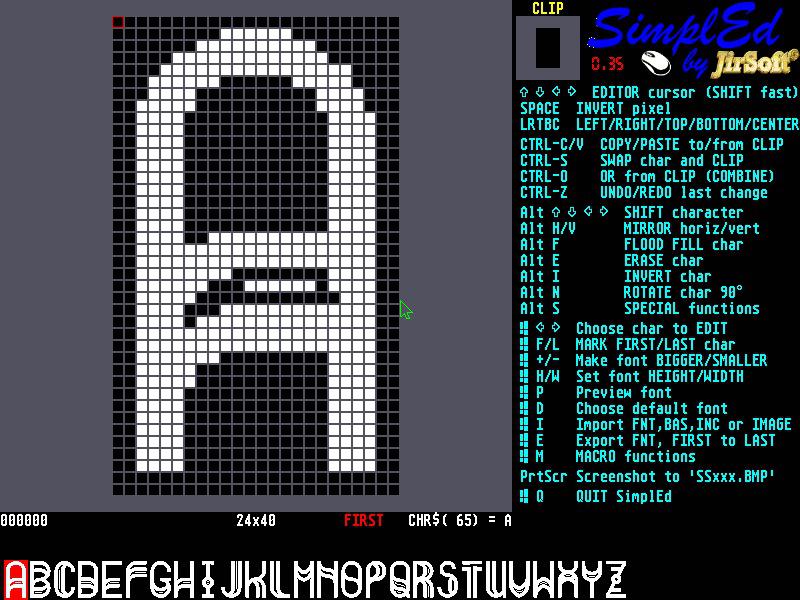

New version of SimplEd (0.35) is here with 2 new features:
First is smaller, but useful, with CTRL+S you swap current character and CLIP, so you can for example faster reorder wrong characters in font
Second is much bigger, you can now in import select also image and  scan it to font. It still needs to be polished, but already works pretty well. Because of it, now you need GRF.INC also for SimplEd (it's on GitHub included in SimplEd repository)...
From this
You will get this
And from this (Mauro's font in DemoX)
You will getthis
Jiri
