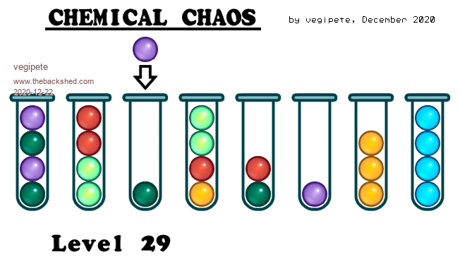

More foolishness from the desk of vegipete.
Chemical Chaos
Apparently, some nefarious actor has infiltrated the lab and randomly mixed chemicals. Sort them and save the day!
Use the arrow keys and the space bar to transfer chemical balls one by one from tube to tube until they are sorted. But watch out! You cannot place a ball on a differently coloured one!
35 levels, generally fairly easy. Some levels are fixed, some are randomly generated. (Usually levels with 2 empty test tubes at the start are random ones. I've never yet found a random level that wasn't solvable but maybe you'll get lucky.)
' ChemiChaos
' by vegipete, December 2020
' Sort the Chemical Balls in the Test Tubes
' Move with the arrow keys
' Pick and place with the space bar
' Restart level with R
' Quit with Esc
'   version 1.0   Original release, graphics tweaks, more levels + counter, intro text
