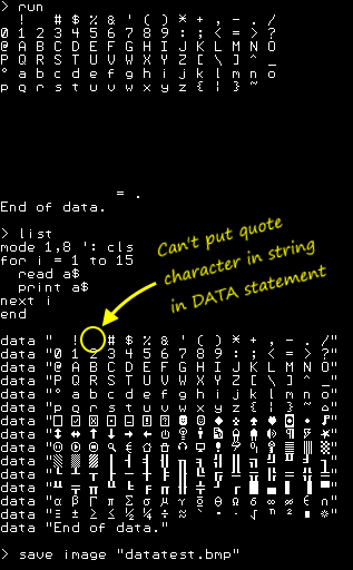

It seems that DATA statements can hold strings with characters with ascii codes greater than 127, but the READ statement cannot read these characters. (CMM2, 5.06.00)
This program demonstrates this: datatest.zip
If you run the program, your get the basic characters and some minor weirdness.
But if you list or edit the program, you see a whole lot more.
Is this true of MMBasic in general or just the CMM2? Is this as intended?

LIST or EDIT the sample program I provided above and compare that to the output from RUN. The fault appears to lie in the READ statement - it doesn't read and return the exact string in quotes in the DATA statement but instead performs some processing.
Edited 2021-01-01 04:18 by vegipete
Posts: 11882
Posted: 06:37pm 31 Dec 2020
Standard across all versions of MMbasic. In the tokeniser:
   // first, make sure that only printable characters are in the line
   p = inpbuf;
   while(*p) {
       *p = *p & 0x7f;
       if(*p < ' ' || *p == 0x7f)  *p = ' ';
       p++;

Here is what it looks like:
Yes, maybe I used some trickery to get the characters into the DATA statements in the first place, but that is my prerogative. Yes, screwy things could happen when doing this but that is for me as the programmer to take care of. I just want a READ statement that reads exactly what's there and lets me mess up on my own terms.
Posts: 11882
Posted: 06:42pm 31 Dec 2020
Sorry - but as per my post this is standard across all versions of MMbasic in Geoff's code and not something I'm going to change

That tokeniser code doesn't explain what's happening.
The '& 0x7F' should strip the high bit, resulting in the normal characters appearing twice.

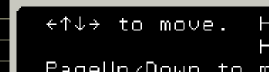

I'm adding a help page to a program nearing release. The following is a screen clip of a small portion of the help page:
My preference is to NOT require extra files. Distribution is in my opinion far simpler if a program is just a single, completely self contained file. So I would like to embed the information for the help page in the program.
A bunch of PRINT or TEXT commands could do this, but editing them is a royal pain. Adding a new line requires manually recalculating all the print offsets. Putting the text into data statements makes maintenance much easier.
But now consider how you would store the above help page clip.
data chr$(149)+chr$(146)+chr$(147)+chr$(148)+" to move."
sure doesn't work.

  Quote  data chr$(149)+chr$(146)+chr$(147)+chr$(148)+" to move."
or
  Quote  data "\149\146\147\148 to move."
I haven't bothered to do the normal escape codes yet but they are easy enough to add to the function.
 READ hlp$
 hlp$ = e_str$(hlp$)
 CLS
 PRINT hlp$
DO:LOOP UNTIL INKEY$ <>""
END

data "When entering an equation, use \[\146\] or \[\147\] to switch to cell select mode."
data "    Choose cell with \[Enter\], \[ Space \] or )*+-/<=>\\^"
