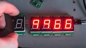

Posted: 01:16am 05 Jan 2021
Those red LEDs would look a lot nicer if you used a red plastic light filter.
It reduces glare and improves the contrast.
Without any filter
With a filter.
Edited 2021-01-05 11:30 by Warpspeed
Posts: 4369
Posted: 09:56am 05 Jan 2021
Thanks for the suggestion Tony.
The phone camera greatly exaggerates the glare, and like I said I'm just playing so it doesn't matter to me anyway.
