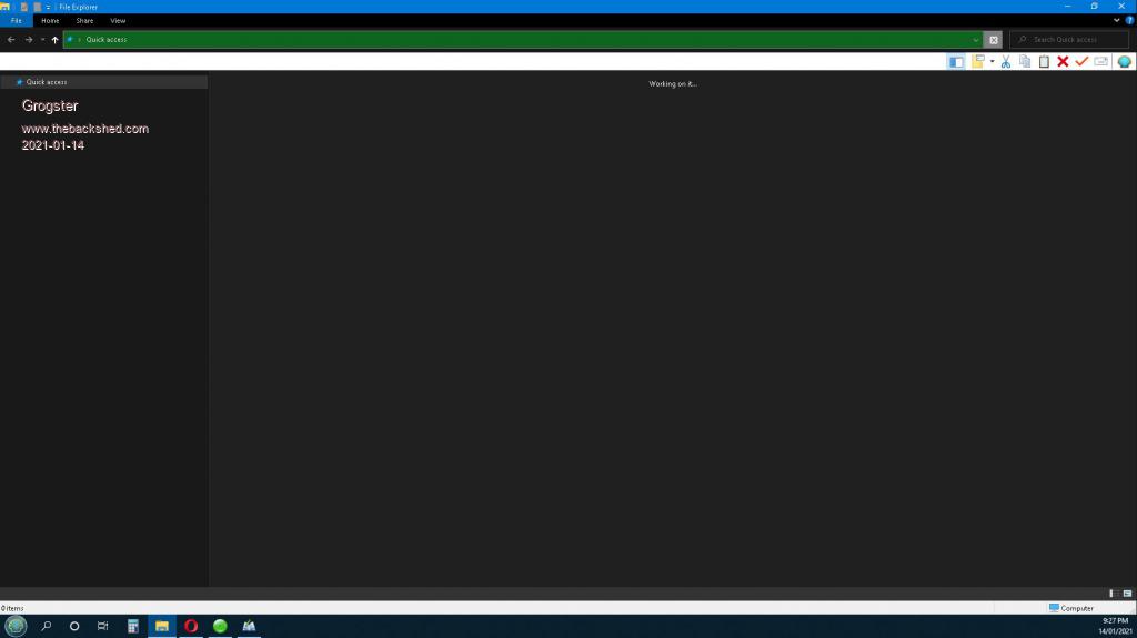

I have several SAMBA2 Linux boxes, mapped to W10 shares, and tonight, one of the boxes stopped responding - according to W10:
Perhaps the share HAS stopped responding, and perhaps there IS an issue with the shares on the LAN.....
Nope.
Can access the shares JUST FINE from another Linux box once I enter the username and password.  W10 is just being difficult - again.  Go figure......
I only have ONE Windoze machine on my LAN now.
It only exists for the CAD I need to run, which is unstable in Linux under WINE.
The ubiquitous windows network issues persist.....
While I wrote this post, it(W10) FINALLY acknowledged the share, but it took more then five mins to do it while I typed.  In Linux, I just opened SAMBA SIMPLE SHARING, and Linux immediately could see the box - and all the other SAMBA sharing boxes on the LAN - enter the U/N and P/W for the box in question, and done.  Probably less then 20 seconds to enter details and connect.  W10 pisses around for 5+ mins before it will even let you see what is on the LAN.

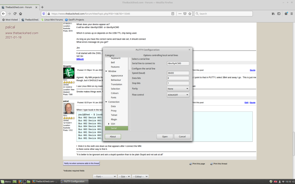

I have tried many times to switch from Windoze to Linux and always failed. This time I am determined to succeed. Most things I have running OK but I have hit a snag trying to connect to my MM on a USB port. I am using Putty and have tried all sorts of things. I am in the dialout group. I can see my device when I type lsusb but just can't connect. In the past I have got this far and given up but this time I am determined. Can anyone help. Do I need a driver for the MM.
Edited 2021-01-16 12:45 by palcal

  palcal said  I can see my device when I type lsusb but just can't connect. In the past I have got this far and given up but this time I am determined.
Whatr does your device appear as?
it will be either /dev/ttyUSB0  or /dev/ttyACM0
Which it comes up on depends on the USB-TTL chip being used.
As long as you have the correct name and baud rate set, it should connect
What errors message do you get?
Posts: 9975
Posted: 03:56am 16 Jan 2021
Agreed.  My MM projects that have the 1455 USB chip, all show up at the /dev/ttyACM0 path in the Linux tree, and so long as I point to that in PUTTY, select 38k4 and away I go.  This is just me though, but it SHOULD be the same for you.

palcal

Posted: 04:51am 16 Jan 2021
When I type lsusb in the terminal I get
paul@Shed ~ $ lsusb
Bus 002 Device 003: ID 1ea7:0066
Bus 002 Device 002: ID 8087:0024 Intel Corp. Integrated Rate Matching Hub
Bus 002 Device 001: ID 1d6b:0002 Linux Foundation 2.0 root hub
Bus 004 Device 001: ID 1d6b:0003 Linux Foundation 3.0 root hub
Bus 003 Device 001: ID 1d6b:0002 Linux Foundation 2.0 root hub
Bus 001 Device 004: ID 04d8:000a Microchip Technology, Inc. CDC RS-232 Emulation Demo
Bus 001 Device 002: ID 8087:0024 Intel Corp. Integrated Rate Matching Hub
Bus 001 Device 001: ID 1d6b:0002 Linux Foundation 2.0 root hub
I  think it is the sixth one down as that appears after I connect the MM.
Is there some other way to find it.
palcal
Joined: 12/10/2011
Posts: 2039
Posted: 05:12am 16 Jan 2021
This is my Putty config.
A window opens with a Can't Connect error.

palcal
Joined: 12/10/2011
Posts: 2039
Posted: 05:33am 16 Jan 2021
Don't know why but I just tried again and it worked.

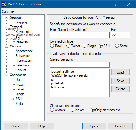

Is there a way to save my config. settings in Putty.

Posts: 6538
Posted: 06:15am 16 Jan 2021
  palcal said  Is there a way to save my config. settings in Putty.
Yes. I don't have putty machine running but where you put in the ports, there is a section below with a save button.
Next time, click on the saved one and press load.
Something like that. I don't use putty much.

Posts: 6538
Posted: 06:33am 16 Jan 2021
OK
This is Putty in Windows but Linux is the same.
Select the top item on the left to see this screen with the save options.

Putty configured and saved OK.
