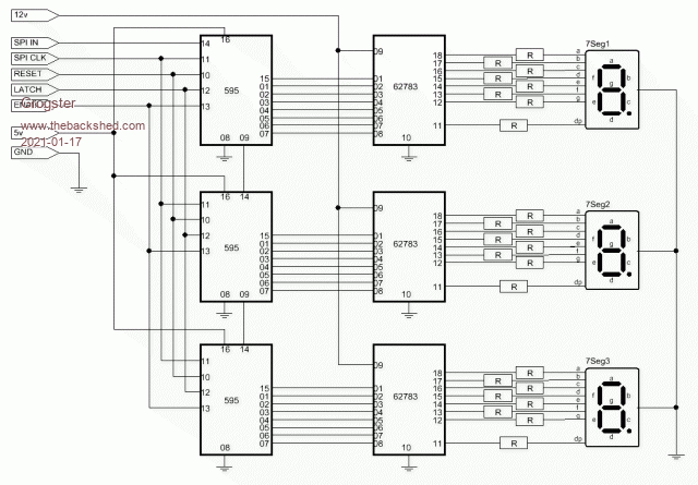

Does anyone know of a high-power version of the 595 driver IC, which is often used to drive 7-segment LED displays?
I have some gigantic 5" LED displays that use 14 LED's PER SEGMENT in a series/parallel arrangement, and so I would need to be able to source 50ma-100mA or so per segment, and the standard 595 can't do that.
I could certainly add a MOSFET buffer transistor to each segment output to provide the current passing ability - that is easy enough to do, but the thought occurs that perhaps there is already a high-power version of the 595 or some kind of equivalent to the 595, that can handle sourcing much more current.
The 5" displays are common-cathode, so I would need to source the current.  I can also get common-anode types if that is somehow easier to sink via a specific device.
What I need at this point, are some part numbers to research.
Can anyone help?
EDIT: I've ordered some 4" ones, as they were about a buck cheaper per unit, and the overall size of the 4" ones is still pretty big! (90mm x 122mm)
These ones just use five LED's in series, and so should be a bit easier to drive.
Assuming the standard 0.7v drop across each LED, I'll need to feed them at least 3.5v, so will probably elect to simply use 5v.  I probably won't need to push as much current through this arrangement though, but I would still like something juicier then the 595, which can only handle 20mA maximum per output with 70mA maximum from ALL outputs, so I would still need external buffers even for the 4" display, so still looking for a more juicy version of the 595 if one exists.

Hi Grogster, I have used these in the past for programmable current and multiple series leds TLC5925
These CAT4016  allow higher led currents but not as many in series.
Mike

I use many Toshiba TBD62783Axx chips as source drivers. These won't replace the '595, but they can amplify (and voltage shift) the output of a '595, or the pins of a MCU or whatever.

Posts: 10043
Posted: 05:44am 17 Jan 2021
@ vegipete: This is how I plan to connect things up....
Does that look like how you would use the 62783's?
Basically, the 595's drive the 62783's, which then drive the large LED common-cathode displays using a 12v LED display voltage.  Value of R yet to be determined.
I would very much appreciate your comments, as you have obviously used these chips before, so I want to make sure I am correctly understanding how to connect them, as I had never heard of them before you posted the part number.

Posted: 08:18pm 17 Jan 2021
I just grabbed a circuit board to compare and it looks like you have essentially matched it. We run series strings of 5 red LEDs from 12 volts using R = 100 ohms. (Actually, 3 strings in parallel, each with its own resistor.)
We use the AFG version of the chip, which works well driven directly from the pins of a 5 volt MCU and should work equally well from the '595s. There are other versions of 62783 that work at other input voltages, just to be aware.
Our PCB is a large 2 digit 7 segment display, so it uses two of theses chips. One of the extra outputs directly drives a smallish 12 volt relay, the other drives a MOSFET PWM display dimming circuit. After over a thousand boards, these chips have never failed.

OK, my 62783's(APG) have arrived from DigiKey, but I am not having much joy.
Pin-09: 12v
Pin-10: GND
Pin-01: MM I/O pin
Pin-02: MM I/O pin
The problem is that if pin-01 or pin-02 is grounded, the LED lights on corresponding outputs pin-17 and pin-18.
If I pull the pin high to 3v3, the LED lights also.
The LED goes out if I pull off the wire to the input side in both cases.
The issue then, is that the LED lights regardless of if the input side of the 62783 is high OR low.  This is not what I expected.  If the input pin is low, the output should be OFF, and if it is high, the output should be ON.
At the moment, the output is high regardless, and only ever switches off, if you FLOAT the input pin.
@ vegipete: HELP!
Posts: 10043
Posted: 05:00am 28 Jan 2021
D'OH!
Expletive deleted, expletive deleted, expletive deleted.........
Fixed it.
Working fine now.
I forgot to common the MM ground, to the 12v ground, so naturally, the 62783 with no common ground reference.......yeah, well......d'oh!

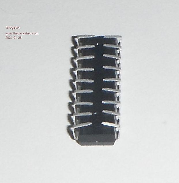

The chips are laser-engraved with "CHINA", so I was at first worried that these might be clone chips, but buying from DigiKey I figure I can be sure they are genuine.
I blew the first one up by putting Vcc and GND the wrong way around, cos I was looking at my PCB design, and forgot that I put the chips on the C2 layer!!!!
Ah.....opps.....
"I think the phrase rhymes with 'Clucking Bell'" - Blackadder.
But the 2nd one I made sure I connected correctly, and it is working fine.
I bought a whole heap of these chips to maximize the DHL courier cost, so I will write this one off as an "Aragog"....

Aragog? I think your picture is of an oh so special surface mount DIP.
