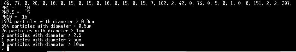

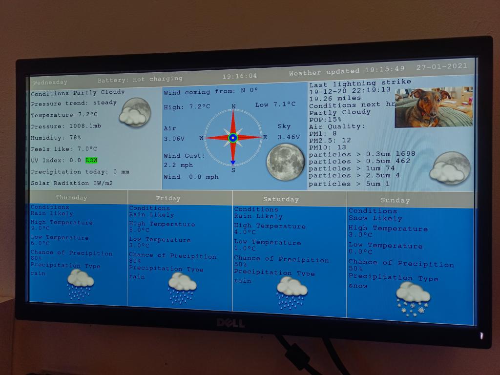

I'm trying to write code to read a sensor that sends data by serial at 9600 baud but I don't understand some things.
I've looked on here and searched Google but was not able to find anything that explained it in simple words I could understand
The format of the data I'm trying to decode is
If I'm right then shouldn't character 31 start with BM? but it doesn't, it changes
This is what it's decoding
I'm trying to understand properly so I don't have to keep asking for help
This is also getting really frustrating having to take pictures of what I want to say so I can post it as the forum keeps saying it contains illegal ascii characters even when none of the ones I use are over 127 most times

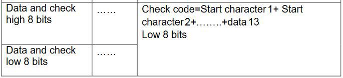

For the checksum, add all the individual bytes together then take the lower 16 bits of the result.

Also I really cannot get how to generate the checksum
As well as checksum, in binary format (its fairly easy to parse the binary format, but it doesn't come out as pure readable ascii text)
Adafruit have a tutorial here but it doesn't tell me in plain english what I need to know
Posts: 3784
Posted: 10:04pm 26 Jan 2021
You have to add +all+ bytes--30 in total--2 start bytes, 2 frame bytes, 26 data bytes.

You have to compare your calculated checksum with the devices checksum
for n = 1 to 30
  checksum = checksum + asc(mid$(b$,n))
next n
checksum_sent = asc(mid$(b$,31))*256 + asc(mid$(b$,32))
if checksum = checksum_sent then print "Yippee!!!!"
to get your values, you multiply the high byte by 256 and add the low byte.

I took one of the strings shown in your first photo and reconstructed the string.
^@ is zero and ^\ is 28
The rest are as expected ^B = 2, ^D = 4 etc.
I didn't try and guess what some of the >128 characters in the first string are.
(It would have been easier with some sample data)
In Australia, we use PM2.5 and PM10 so I looked it them. Both were 4 which is reasonable for indoors.
I haven't studied the smaller particle sizes so will not make any comment on those values.
By reading the string from DATA statements instead of the serial port, this is what I ended up with.
There is a difference of 256 between the check-sums. 256 is interesting and I would like to see more packets to see if that is a constant error/difference.

     'IF CHECKSUM = PREVIOUS CHECKSUM DISREGARD READING WE ONLY WANT DATA WITHOUT 2 CONSECUTIVE CHECKSUMS because unit sends data every second but only updates the readings every 2.3 seconds therefore we only want new data to display
     'Only need values from Data7 high to Data12 low
     e = asc(mid$(b$,17)) 'Data7 high
     f = asc(mid$(b$,18)) 'Data 7 low
     g = asc(mid$(b$,19)) 'Data 8 high
     h = asc(mid$(b$,20)) 'Data 8 low
     i = asc(mid$(b$,21)) 'Data 9 high
     j = asc(mid$(b$,22)) 'Data 9 low
     k = asc(mid$(b$,23)) 'Data 10 high
     l = asc(mid$(b$,24)) 'Data 10 low
     m = asc(mid$(b$,25)) 'Data 11 high
     n = asc(mid$(b$,26)) 'Data 11 low
     o = asc(mid$(b$,27)) 'Data 12 high
     p = asc(mid$(b$,28)) 'Data 12 low
     print e,f,g,h,i,j,k,l,m,n,o,p ' print all values to check
     particles_03um2 = e*256 + f  'value  I'm **ASSUMING** we add the values?
     particles_05um2 = g*256 + h  'value
     particles_10um2 = i*256 + j  'value
     particles_25um2 = k*256 + l  'value
     particles_50um2 = m*256 + n  'value
     particles_100um2 = o*256 + p 'value
     print "Particles > 0.3um / 0.1L air: " STR$(particles_03um2)
     print "Particles > 0.5um / 0.1L air: " STR$(particles_05um2)
     print "Particles > 1.0um / 0.1L air: " STR$(particles_10um2)
     print "Particles > 2.5um / 0.1L air: " STR$(particles_25um2)
     print "Particles > 5.0um / 0.1L air: " STR$(particles_50um2)
     print "Particles > 10.0 um / 0.1L air: " STR$(particles_100um2)
   END IF
 END IF
END SUB
 data 66,77, 0,28,0,2,0,4,0,4,0,2,0,4,0,4
 data 2,97 ,0,24,0,28,0,2,0,0,0,0,23,0,2,111

In the datasheet it says
Check code=Start character1+Start character2+........+data13Low 8 bits
Could that mean add characters 1 - 12 + data 13 low bit?
then if it's the same as characters 31 and 32 it's valid?
OR does it mean add characters 1 + 2 + data 12 low 8 bits?

  Quote  Check code=Start character1+Start character2+........+data13Low 8 bits
That is a bit confusing but I think it does mean to add all of the bytes from Start character1 to the data byte13low to get the checksum which is a 16 bit number. As Jim has done.

  Quote  I get what you're saying, that the checksum works BUT
it's not the same as comparing it to the checksum sent by the device?
The checksum sent by the device is high byte 2, low byte 77.
(2 * 256) + 77 = 589 decimal.
It does agree with the calculated checksum.

Surely this can't be right?
If that is the case then with this data
66 77 0 28 0 31 0 43 0 48 0 26 0 38 0 47 22 77 6 77 0 230 0 17 0 6 0 2 151 2 3 226
then the
PM10 particle count is data 10* 256 + data 9  which is 48*256+0 = 12288
PM2.5 particle count is data 8* 256 + data 7  which is 43*256+1 = 11088
PM1.0 particle count is data 6* 256 + data 5  which is 31*256+0 = 7936
Those values seem really high?
Especially for indoors
