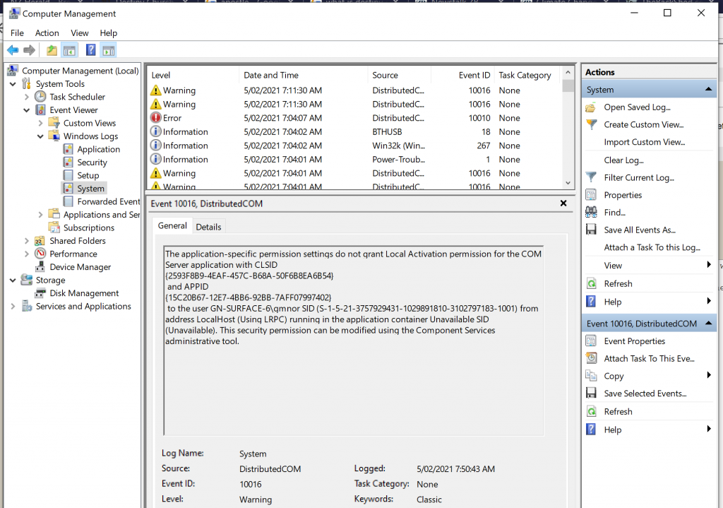

I got a laptop today(HP) that the client was complaining that everything was slow, and nothing would open.  She is 100% correct.  The system boots, but insists on a system disk check on EVERY boot, but access is INCREDIBLY slow.  START menu never opens - you just get the "Busy circle" for a few seconds, but it never opens.
Most applications won't open.  Same "Busy circle" for a few seconds, but the apps never open.
8GB of RAM and 1TB HDD.  My first thought, is to clone to an SSD and see if that helps, but I can't even install Macrium Reflect, as no web-browser will open despite many attempts.
I suspect that this copy of W10 is seriously corrupted.
Cloning it to an SSD would probably speed it up, but the problems would also be cloned.  It is also quite possible that the HDD is dying, and that is causing all the issues.  I am thinking more along the lines of a clean install over anything else, BUT also a clean install to an SSD and not the slow HDD.
Thoughts?

Have you tried looking at the "system" logs which are found in the "Event viewer" which is found in "Computer Management"
They take a while to be displayed under normal circumstances so with a slow machine it will probably take a while longer.
Start by looking for things flagged in red.

@ GlenO: Hello fellow Kiwi!  Had not thought of that, so I will try to see if I can get anything useful out of that - but it might be impossible, as the START menu refuses to open, so I can't actually select Computer Management in the first place...
