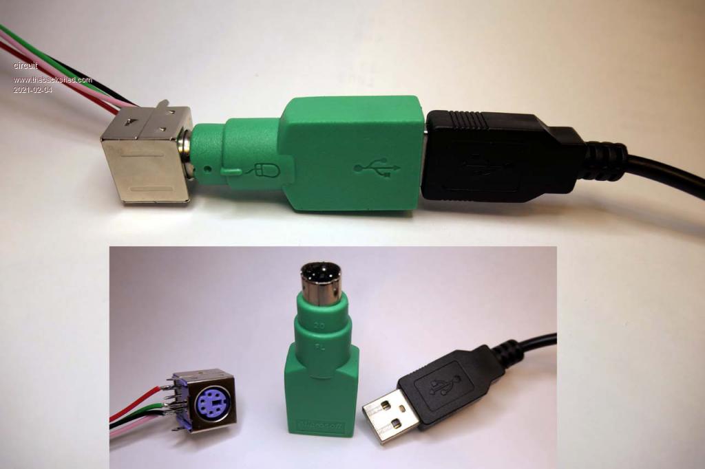

I have a keyboard connection to a MM Plus in the prescribed manner and it works fine with a standard PS2 keyboard.  The latter are becoming somewhat scarce and therefore I tried connecting a contemporary USB keyboard using an old Microsoft USB-PS2 adaptor as in this illustration.  It works perfectly!
My question is what is going on in the adaptor?  Is it in anyway active or is it just a wiring pass-through?  I am hoping that the latter is the case and that I might be able to cut off the USB plug and just wire a four-pin molex connector instead.  If the adaptor is in anyway active, what components would I need on my MM Plus motherboard to replicate its function?

I don't think there is anything going on inside the adapter... Just a wiring pass-through as you have said... just change the plug... Should be ok...

What puzzles me is that the PS2 keyboard connections to the MM+ are "keyboard clock" and "keyboard data".  USB lines are "Dataline positive" and "Dataline negative".  How do these line up?

As you and Zonks have already said, there is nothing clever inside the green jobby, the work is being done by the keyboard controller. "early" USB keyboards were auto-sensing.
There was always the intent that such controllers would be stop-gap during the transition but it is only software so if it is costing nothing... a lot of modern keyboards will still support PS2 through such an adapter - evidently legacy software/module includes with the manufacturers either deliberately or just no-one has paid to have a turf-out/do-over. I wouldn't expect it to last forever.

Thank you - that clarifies things enormously.  So, upon detecting a clock signal the keyboard is reconfiguring itself so that the USB wiring "data minus" line becomes the clock line.  Excellent!  Out will come the wire-cutters and the "gang of three" will be reduced down to a simple four pin Molex.

Correct - PS/2 clock connects to USB D+.
Most PS/2-USB converters include two 4.7k pullup resistors but that can vary.

The Microsoft USB-PS2 Adaptor does indeed have 4.7K pullups on both the D+/Keyboard Clock and the D-/Keyboard Data lines.  Acknowledging @Tassyjim, not all the USB-PS2 adaptors have the pullups and they do not work without the optional 4.7K pullups on the MM+ side. I tried a Kensington adaptor and it does not have pull-ups.
Therefore, forget the adaptor.  To determine if any USB keyboard can function with the MM+, firstly make sure that the optional pull-ups are installed as on Page 45 of the MicroMite Plus manual. Connect the power leads and then Keyboard Clock to USB D+ and Keyboard Data to USB D- and set "OPTION KEYBOARD language".    I guess that the closer the date of manufacture of the USB keyboard is to the withdrawal of the PS2 keyboard plug, the greater the chance of it working.

If that purple socket fits into a PCB footprint like this:
Which pins (holes) are 5V,0V,kbd clock, and kbd data?
And are the big pointy feet in line with the 4-pin row? If offset, by how much?

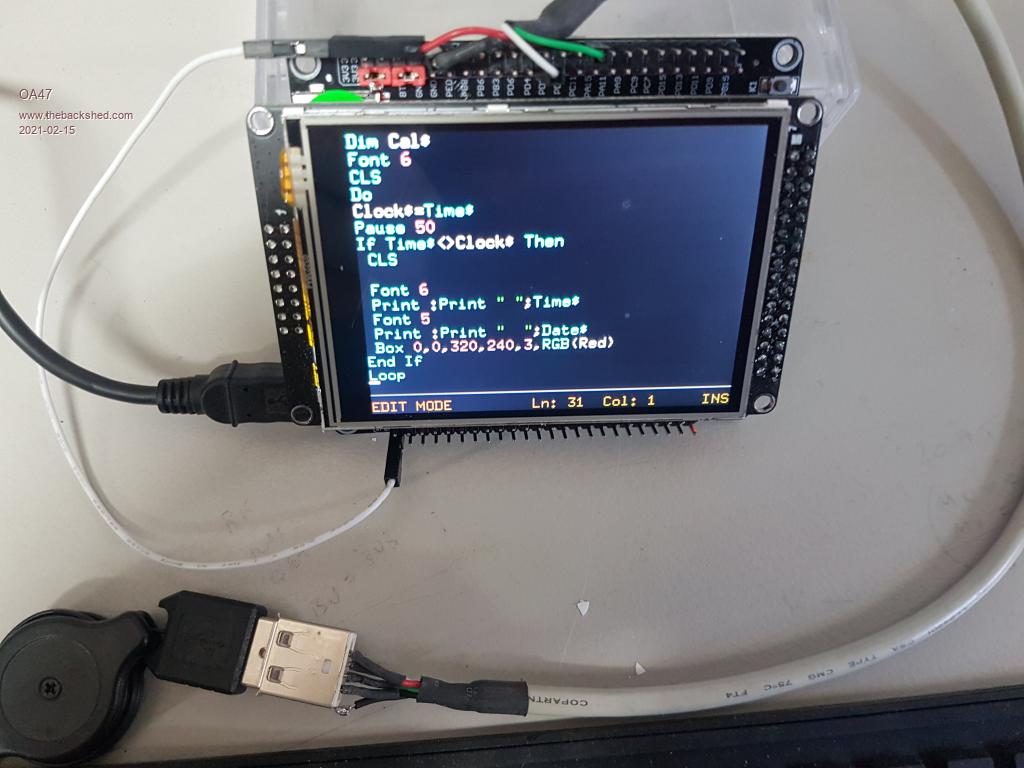

I decided to check through my collection of keyboards with usb connection that will support PS2 and other than a couple of Msoft versions I was delighted to find that some small flexible (roll up) keyboards that I purchased from the local Woolworths store for a couple of dollars do also work.

Re PS2 PCB pads - have probed a socket and the results are (for your photo):-
Top Left - Clock
Bottom left - Ground
Bottom Second from Left - Data
Bottom Right - +5V
Bottom Second from Right - NC
Top Right - NC
As for the location mounting pins, every brand is different so you will measure your socket.

Thank you very much. I have the pads labelled now on the PCB.
