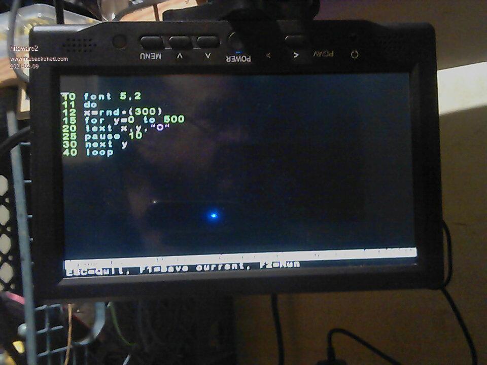

By more than going to MODE 8 ?
I would like to use an available small monitor .....
my site
Posts: 6538
Posted: 05:00am 07 Feb 2021
OPTION EDIT FONT SMALL | NORMAL | MEDIUM | LARGE
For V5.07 beta 11, Peter says:
  Quote  I've added a new edit font OPTION EDIT FONT VERY LARGE for use with high resolution modes
That should keep you happy
Edited 2021-02-07 16:14 by TassyJim

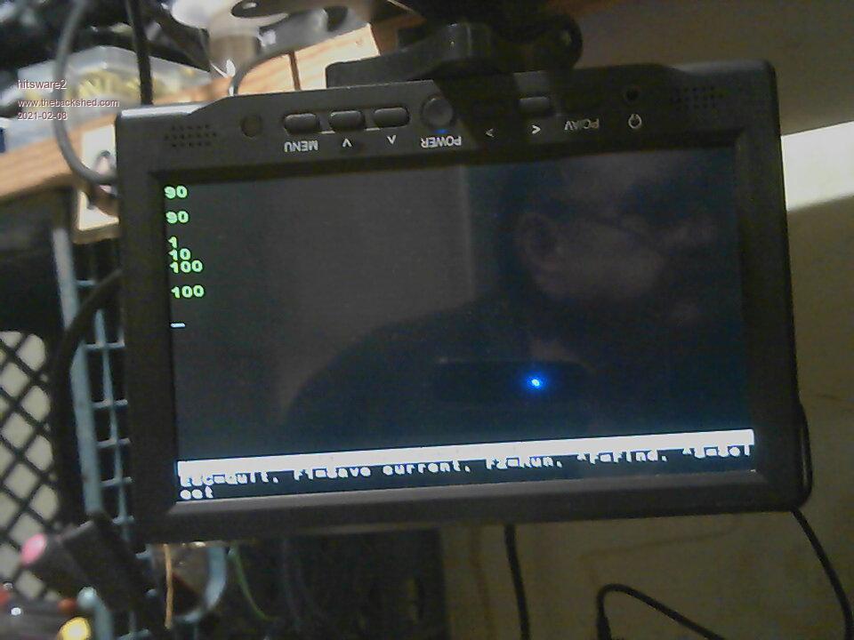

After I type in :
10 (enter)
through
100 (enter)
(step 10)
I get :
Edited 2021-02-08 10:04 by hitsware2
my site
Posts: 11499
Posted: 08:21am 08 Feb 2021
What resolution are you running? The issue is that with the very large font the status line is too long and is wrapping
UPDATE
Fixed in b12
Edited 2021-02-09 02:20 by matherp
