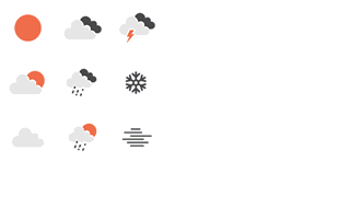

I downloaded some icons from https://openweathermap.org and cut and pasted them into a single bmp, and downloaded to my F4 to make sprites (blit buffers). When displayed, the grey areas indicating clouds display as white.
I went back to the PC and reduced the color depth to 24 bits in PaintshopPro, saved it and downloaded it, but the clouds still show up white.
What do I need to do to get them to show up as grey? (I've converted to png so I could upload to the forum.)

Make the gray darker.

  vegipete said  Make the gray darker.
Clearly. The question is how?
In your paint program of choice load them and flood fill with a different color.  Even windows paint can do it.

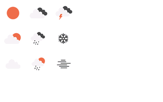

That has the clouds set to RGB(230,230,230)

Thank you, Jim. How did you do it? (Teach a man to fish ...)
Posts: 6606
Posted: 12:17am 08 Feb 2021
Windows paint
Edit colours to select a suitable colour
Use the fill tool - image of paint pot being poured.
Click in each cloud and the cloud changes to the selected colour.
Paint has an undo feature so it is safe to play around.

Thanks. I'll try it, rather than just using yours.

I also changed the sun to yellow rather than red. Much better. And learned a new technique. Thanks again, Jim.
