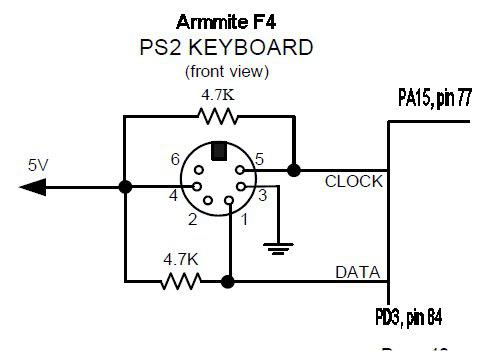

Final Q
Can we add a keyboard to the F4 and program it directly?
N
Posts: 11513
Posted: 11:49am 15 Feb 2021
yes: a PS2 keyboard can be connected with a suitable adapter and pullup resistors

  lizby said
  Nimue said  Can we add a keyboard to the F4 and program it directly?
Here
And here
Cheers -- I see these posts and continually think I must be missing something -- I read them and know its possible - but not how to do it -- what to wire where etc etc.
I'll keep poking, buy the kit and experiment.
N

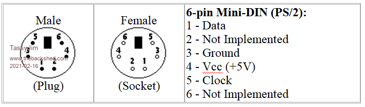

Posts: 3784
Posted: 02:46pm 15 Feb 2021
  Nimue said  . . .needed a noob 101 guide.
Don't we all. What I am not absolutely certain of in that diagram is whether we are looking at the connector from the keyboard or the connector that it plugs into. I think the connector that it plugs into, but will check with multimeter when I get my PCB PS/2 sockets.
