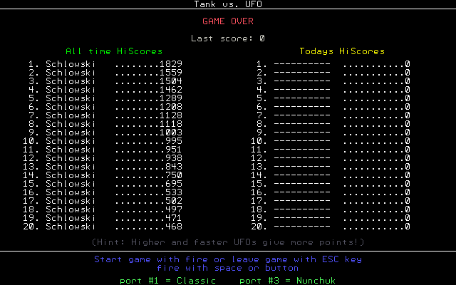

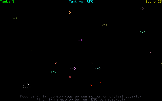

As a snake clone already exists I took the chance to make a conversion of the classic Tank versus UFO from the VIC-20 user manual.
As the CMM2 is a little bit more powerful than the good old VIC it should be called Tank versus UFOs.
I tried to auto-detect Nunchuks and Classic controllers in ports 1 to 3, support the digital joystick with the following pins as in the CMM2 deluxe
const DUP = 35
const DDOWN = 36
const DLEFT = 38
const DRIGHT = 40
const DFIRE = 32
Any button on the digital or classic controller or nunchuk including shoulder buttons and select, home or start act as fire buttons.
Any directional control, analog or digital can be used to move your tank left or right.
Of course it's possible to play with keyboard, use cursor keys to move and space to fire.
There's no sound as I'm worse in sound compared to graphics :-)
Or positively spoken it's only a single .bas file with no additional files and can be started from anywhere.
TankVersusUFO.zip

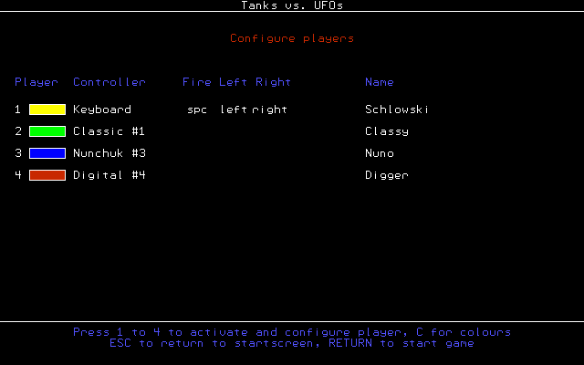

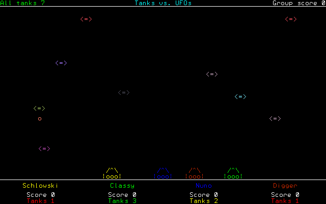

Here you go, Multiplayer Tanks vs. UFOs, up to 4 players.
Freely configurable user inputs, multiple keyboard controls possible:
Multiplayer arcade action for your home:
If you switch the colors in the configuration to all players white the confusion is perfect :-)
Hopefully not too many bugs, it's really difficult to test a multiplayer game as a single developer!
TanksVersusUFOs.zip
