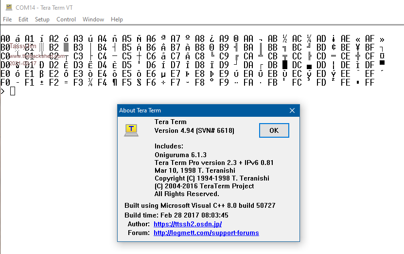

Setting found under 'Terminal"
Which version of TeraTerm ? - no such setting for version 4.105
Posts: 6538
Posted: 08:59pm 16 Feb 2021
  thwill said
  TassyJim said  Have you tried changing TeraTerm to use code page 437?
4.94

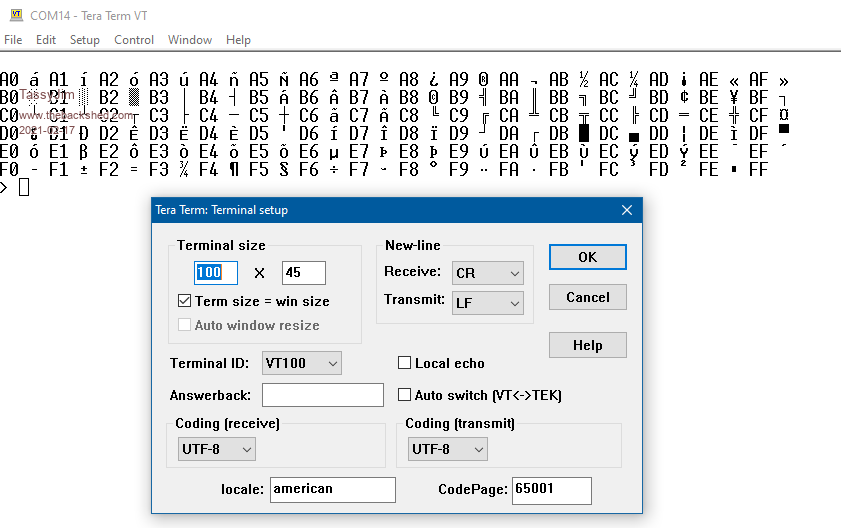

Posts: 4369
Posted: 09:05pm 16 Feb 2021
  TassyJim said
  thwill said  Which version of TeraTerm ? - no such setting for version 4.105
4.94
So an older version ... I've just installed that and still no such setting.
This is weird - can you post a screenshot of the dialog and the about box ?

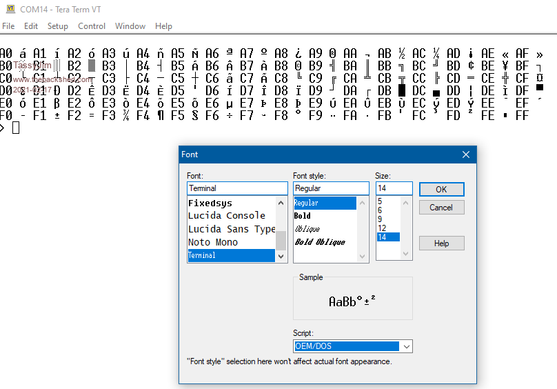

Posts: 6538
Posted: 09:40pm 16 Feb 2021
I did a few tests.
CP65001 and CP437 both display the same extended ASCII characters so no help for you there.
I use Terminal font. It can be difficult to find fonts that have the line drawing characters.
I suggest that you have some odd setting in your teraterm.ini file. Delete it and start fresh.
Edited 2021-02-17 07:43 by TassyJim
Posts: 4369
Posted: 09:57pm 16 Feb 2021
Thanks Jim.
  Quote  I suggest that you have some odd setting in your teraterm.ini file. Delete it and start fresh.
That doesn't appear to be the case. To display the two "Coding" fields requires a change in Setup->General to use UTF-8 before they are displayed but I'm still to discover what setting needs flicking to show "CodePage".
I independently discovered that the key was using the "Terminal" font, but even that doesn't contain the full Cp437 set of line-drawing characters (it doesn't contain the junctions between double and single line borders).
Anyway I think I've got as good as I'm going to get from TeraTerm now, so thank you for your help.

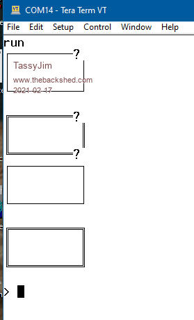

For me, with Terminal font set in Teraterm, both CP65001 and CP437 have the anomaly of not printing the upper right corner, single or double, or double lower right corner if preceded by the appropriate horizontal line character.
In MMBasic DOS, the code draws the boxes properly.
Posts: 4369
Posted: 12:16am 17 Feb 2021
  lizby said  For me, with Terminal font set in Teraterm, both CP65001 and CP437 have the anomaly of not printing the upper right corner, single or double, or double lower right corner if preceded by the appropriate horizontal line character.
I believe it is happening because you have TeraTerm configured to receive UTF-8 and 0xC4BF just so happens to be a valid UTF-8 character so those two bytes are interpreted as a single character and it happens to be a character not present in the font you are using, so you get a ? When you insert the space you break the byte sequence and hence get the expected characters.
The same doesn't happen for all the horizontals because 0xC4C4 is not a valid UTF-8 character.

Posts: 6538
Posted: 06:44am 17 Feb 2021
  Quote  Where does 0xC4BF come from? I thought I was sending chr$(191) or 187 or 188.
That is the HEX equivalent to the decimal numbers.
I don't think that is the problem though.
I remember the corners causing grief many years ago but forget where and what I did about it.
You can get around it by drawing the corners first then backspacing to draw the lines.
Crude but it does work.
PRINT CHR$(218);: FOR i=1 TO 10: PRINT CHR$(196);: NEXT i: PRINT CHR$(191)
PRINT CHR$(179);: FOR i=1 TO 10: PRINT " ";: NEXT i: PRINT CHR$(179)
PRINT CHR$(192);: FOR i=1 TO 10: PRINT CHR$(196);: NEXT i: PRINT CHR$(217)
PRINT

Posts: 4369
Posted: 09:47am 17 Feb 2021
  TassyJim said  I don't think that is the problem though.
In TeraTerm:
1. Go to [Setup->General...]
2. Change "Language" from "UTF-8" to "English"
3. Re run program
4. Question marks go away and boxes are displayed correctly
5. Think, "Huh, I guess Tom's theory may have been correct, what are the chances of that happening?"
Or it may just be coincidence
Have a nice day.
Edited 2021-02-17 20:02 by thwill

Posts: 4369
Posted: 01:57pm 17 Feb 2021
  lizby said
I understand that 191=0xBF, but where does the C4 come from?
C4 is 196 which you are expecting to be the single horizontal line box-drawing character.
What follows is educated conjecture there may be another explanation for the facts:
Since your terminal was set to handle UTF-8 the two bytes:
       Chr$(196) + Chr$(191)
are interpreted as the single UTF-8 character U+013F (Latin capital letter L with middle dot), don't ask me how the conversion works
Because two bytes are converted to one character the resulting line is short by one character, and because the font you are using doesn't contain that character it is rendered as "?"
When you change the "Language" to something other than UTF-8 I would conject that TeraTerm interprets individual byte values as the first 256 characters of language specific fonts ... though it may be more involved than that.
