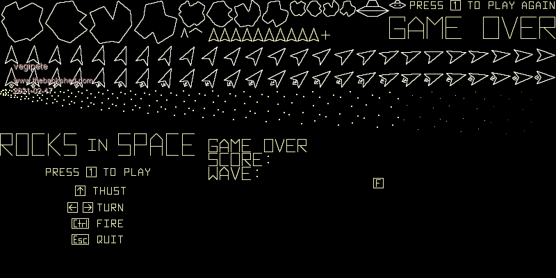

Here is the sprite sheet I created for the game "RocksinSpace":
Note there are various different sizes of shape, and while the shapes are
organized in patterns to some degree, there is no single rule to extract any
particular shape.

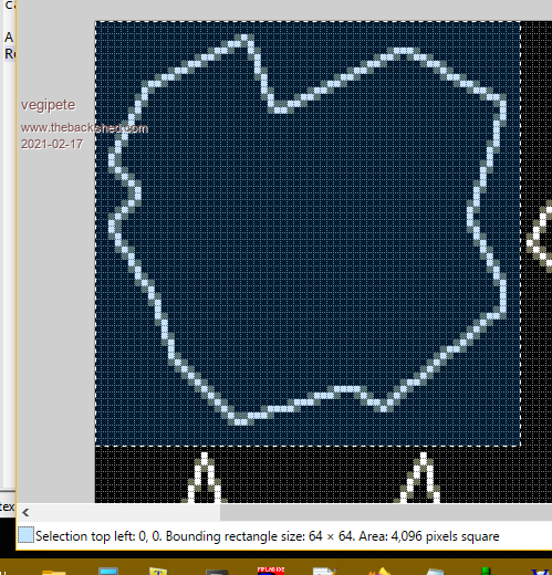

A bit of thought goes into placing the shapes as they are created. Using the
Rocks in Space sheet, we can see that the first large asteroid is located at
(0,0) with size 64x64. This pattern is repeated for the next 3, every 64 pixels
to the right. This allows the 4 large asteroids to be extracted mathematically,
starting from the base location of (0,0)

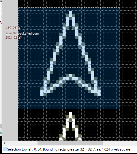

Knowing where the large asteroids are, the two rows of player ship can be added.
The base location is (0,64). Remember, the large rock is 64 pixels, from 0 to 63.
Each player ship is in a 32x32 pixel box. The use of a fixed pattern makes the
individual shapes easy to extract mathematically.

How should you arrange your sprites? One sheet, many sheets? That's really up to you. It certainly does make sense to assemble all interchangeable sprites the same size together in neat rows. As long as you know where the first one is, you can calculate the rest of them. As you can see by the Rocks in Space sheet above, I just laid them all out in one. The program knows where to find each piece. The dispersing wreckage cloud is interesting, because the shape grows for each step along the animation cycle. The y-coordinate of the source shapes is constant. The x-coordinate and the size are stored in arrays, so finding a particular shape becomes easy.
It's worthwhile to test which is faster: use values stored in a pre-computed array, or compute on the fly. I use both.
