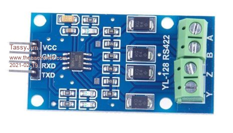

Posted: 08:13pm 18 Feb 2021
I agree with Peter.
If you only have 2 cores available for data, RS485 but I like RS422 for full duplex without any need for the extra control lines.

Posted: 01:13am 19 Feb 2021
RS422/RS485 is a differential protocol (2 wires per communications channel). GND is handy to have, but not absolutely essential. With a 6+ core cable (eg: ethernet cable) GND, +V and full duplex communication is easily achievable (in fact, doing it with my current project). Being differential speeds can be significantly higher. I am doing 56kbaud over a meter (for testing) and fully expect that to go at *least* 20 meters. My limits are actually going to be set by the voltage drop on the power conductors and not by the baud rate. Does require a little bit of hardware though.
RS232, especially TTL level, is single-ended and pretty good for several tens of meters, but as others have pointed out, distance drops rapidly with higher baud rates. Good for duplex with four cores (with GND and +V), but ethernet cable is cheaper than most other alternatives now anyway. Less than 8 core has become "only if the cable already exists". And for quick and dirty, the wires can be connected directly to the micro with no extra hardware required! Although I'd be expecting to replace my micro on random occasions with such a setup.
